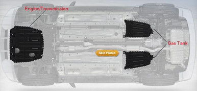

Since your goal is to actually take it on rough roads you'll want to invest in the oem skidplates - they're discontinued but there appear to still be a few on shelves because almost nobody actually buys them. After all they aren't visually compelling and nobody spends money on things they can't show off.
There are two for the fuel tank and one for the engine/transmission. They're stout and provide comprehensive real protection. There are also recovery rated front tow hooks you can purchase, as well as a recovery rated rear hook (or if you have a receiver hitch you can use that for rear recovery).

OEM skid plates here:
You can search these part numbers for pricing
5105236AB - Main Skid Plate (1)
5116330AB - Passenger's Side Plastic Shield (1)
5116057AC - Driver's Side Plastic Shield (1)

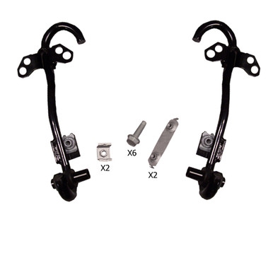

OEM front tow hooks here:

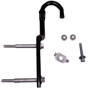

OEM rear tow hook:
OEM rear tow hook:
