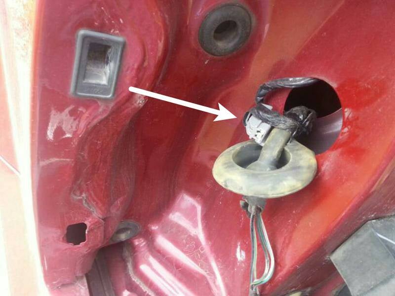

What I think they mean is theres a wire already behind the left tail light that has power on it that you can run to your wiring converter....I just installed a Curt trailer wiring harness and I used the wire behind the left tail light for power....If someone knows more than I please chime in........
Let me explain better,remove left tail light assy and you will see a rubber grommet ,remove grommet and you will see a single wire taped to the harness that should be your power wire that powers your trailer wiring module...Now just maybe you can have all the wiring already there somewhere IDK.....
Here ya go man,

No you just need to tap into the hot lead behind the driver side tail light grommet. Its the plug with the arrow pointing to it a couple posts ago. Just cut a small hole in the grommet so you can send the inline fuse wire through. Shave one inch off the hot lead wire cover and send the inline fuse power wire through thexposed wire of the hot lead. Tape up the all exposed wire and put the grommet back on.

Just one on the trailer lead. Its the plug that the arrow is pointing to in the picture. Just cut about an inch of the covering and pull it back. Slip the curt power wire through the middle of the trailer lead wire and tape it back up. Don't forget to pull the curt wire through the grommet first.
