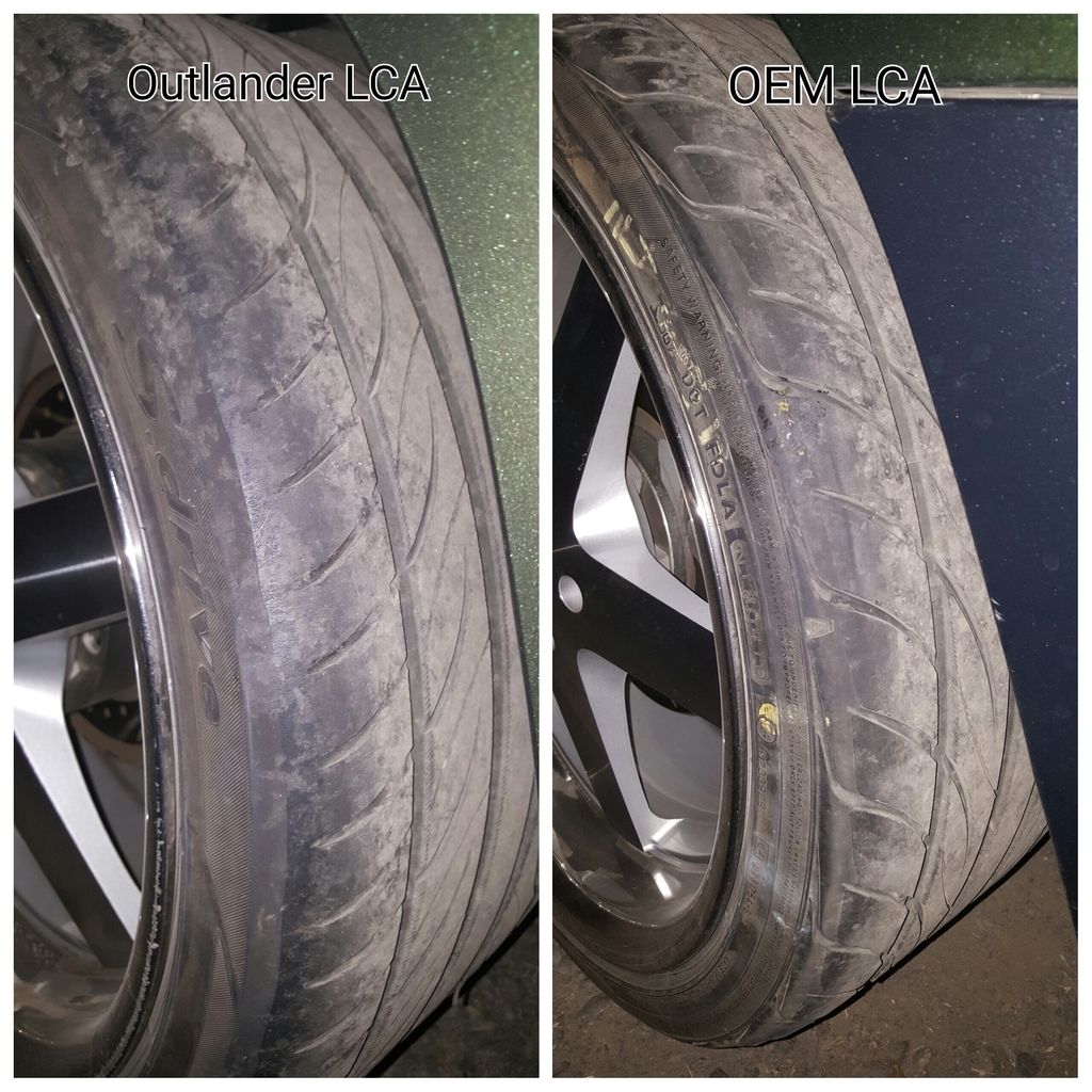

Recently got my tires (halfway) rotated. Wanted an X-pattern rotation to get some fresh tread on the pavement due to my camber. Well, Walmart is still full or retards with wrenches and they didn't understand that I basically wanted all 4 tires inverted. They only did 2. This is after they only swapped fronts to the back. 6 times I've gone to Walmart for tires on 3 different vehicles and there's always SOMETHING the mess up. But it only cost me $40 and I got my TPMS's installed finally. Whatever.
Here lies more evidence that the 2008 Mitsubishi Outlander control arm does NOT fit properly in (at least MINE) a Patriot. It kicks the tire out of the fender more. Look at the angle in both tires, and the excessive camber wear on the one with the Mitzu arm.
This being said, if you still want these, do them in pairs, and get your Camber aligned. I'll go buy a new ball joint and press it in my OEM LCA and swap it back in soon.
Standard procedure for a 4 tire rotation is FR to RL, LF to RR and move the backs to the front. silly Walmart:doh:
(If you're ever in the UP I'll do it properly for $15(substitute whisky/rum or other random stuff with approval) and 30 minutes:D)
Might be almost as cheap to buy a 2nd Outlander arm and $15 camber bolts?

Lol well their excuse was "since they were directional, we only do front to back" then I told them I wanted the X pattern, and we even entered that in the computer at the desk. The guy was like "we'll that would require taking the tires off the wheels" and I said you already had them off to put the TPMS's in.... ridiculous. I'd totally take ya up on that offer if you weren't so far away haha. But I do have adjustable coil overs so I can set my camber up front. I'll just spend $30 and get a new ball joint. I can get em in by hand. Did it on my E30. Just takes a little effort and a vise haha.
#82 ·
Well there's your problem...lol
:doh:
been contemplating getting an air hammer to assist with this kind of thing since it seems inevitable that it'll need doing on most of my suspension.
