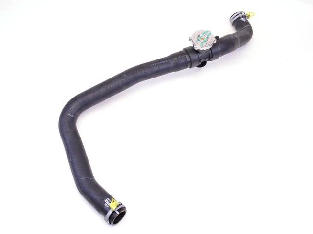

So, while I was working on my breather box I inadvertently broke the t-filler neck for my cooling system. I am having trouble finding just the t-filler neck and the clamps. Does anyone have a lead on the t-filler neck and parts or do I have to buy the entire assembly with hoses and all?
Radiator fill neck, or CVT fluid fill neck? The latter quite commonly breaks(unfortunately), but I don't think I've heard of the former ever being broken. I'd recommend checking with your local dealer parts department, or maybe diagrams at www.moparpartsoverstock.com or www.allmoparparts.com.
partshotlines.com maybe?
some pats (like mine '12 fwd cvt) got the oil cooler upgrade but its gonna be a hard find. you may have to buy new.
warning! for the cvt you may need the manual hose kit not the automatic trans kit.
while youre at it the hoat antifreeze is only good for 6 yrs or 100k so you may want to change it.
also never fill from that cap. always fill from the overflow.
It's a just an inline radiator filler neck. Measure the exist pipe/inside hose size and match it up.
