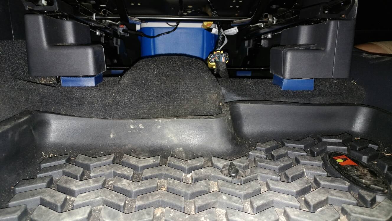

My friend machined some polymer blocks for me that worked great. I did 1 inch in the back and 3/4 inch in the front. I really like it. I don't seem to be sitting "down into" the vehicle as much anymore. The blocks are blue in the photo.
