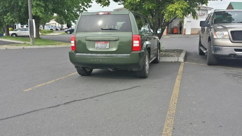

my Jeep is green. quad lights were uber easy. go to your local auto parts store and get a couple 3157 housings (most have gm brand), a couple 3157 bulbs, and at least 6 "T-Taps". then take your brake light housing off. on a piece of paper, trace the 3157 housing so you can cut a template. then trace that template on the back of the bottom of the housing where the rear fogs (euro models only) go. cut it out carefully and plug in your new housing. then take the wiring and using t-taps you can tap into the stock harness without cutting. the computer doesnt care about the extra load so dont worry about getting leds. I would have done a write-up but I dont have a dremel, and my leatherman was in Oregon getting repaired, so i drilled a bagillion little holes with a tiny drill bit and used a razor lol. it took FOREVER, and looks hideous, but it works :)
it's the #1 mod EVERYBODY with a Pat should do! you can even take it further and add a couple more backup lights to the extra clear lenses if you dont have independent turn signals. I may do that later on just to fill it up. Some people even put fog lights in there on a separate switch.
