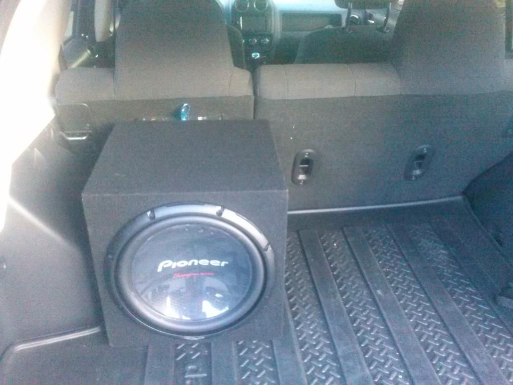

This is exactly how I had mine in my 2012. Just bought a 2014 over the weekend and took my amp and sub out. Not sure if I want it in there anymore. The sub was just a little larger than yours but I thought it took too much room. I want the sub sound but without taking my cargo space. Hopefully I will find a good alternative here.
I had my amp mounted to my sub box originally but opted to move it to utilize cargo space when needed. I moved the amp under the false floor right above the spare tire. I secured it using hook and loop tape to prevent having to drill. The amp doesn't run hot and when I need the space I can pull out my box.
