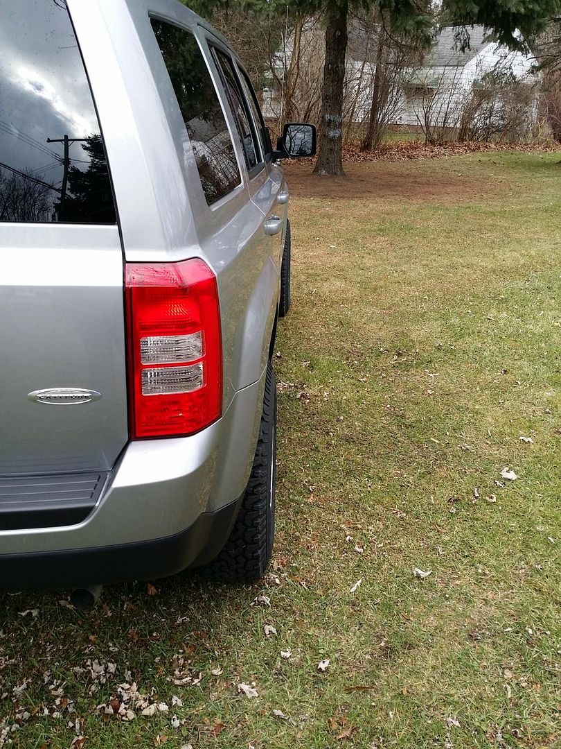

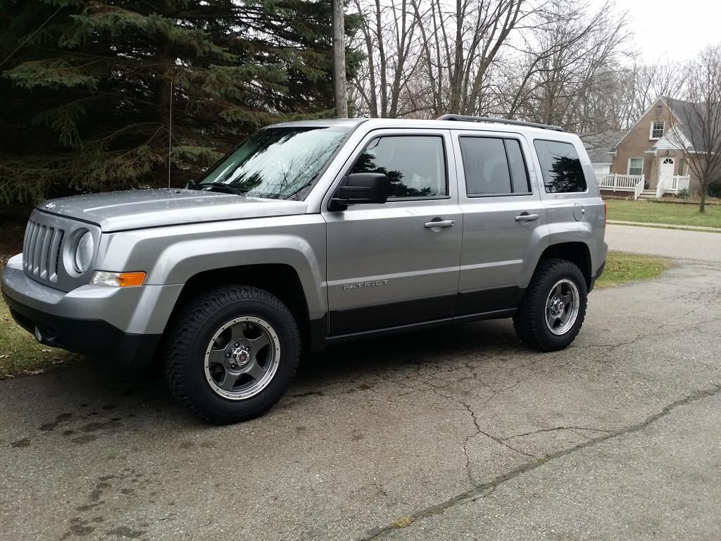

Just got my tires and rims installed today:
PRO COMP XTREME ALLOY 16x8 Wrapped with BFG DURATRAC A/T 225/70/16
Second setup was because I personally wasn't happy with the first.
I think this setup is perfect for a non lifted Patriot, even a 225 75 15
would work well.
Level 8 Punch 15x7 zero offset
215 75 15 BFG All Terrain KO
Thank you for this! It's by far the cleanest look I've seen. Simple and matches great with the silver Patriot. Our 14' Patriot has the stock 15" steel silver wheels and they look so bad/cheap. I love how those wheels look in your pictures. I've never heard of that brand and after some research they are about $100 a wheel which is cheap to me... are they reliable/good brand?
Have zero desire to lift the patriot either but having nicer wheels/little larger tires would be nice. Just don't want anything to rub.
Thanks,
-Nigel
