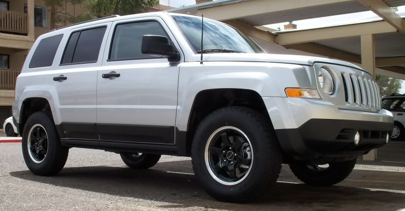

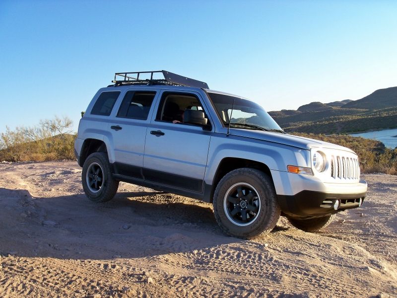

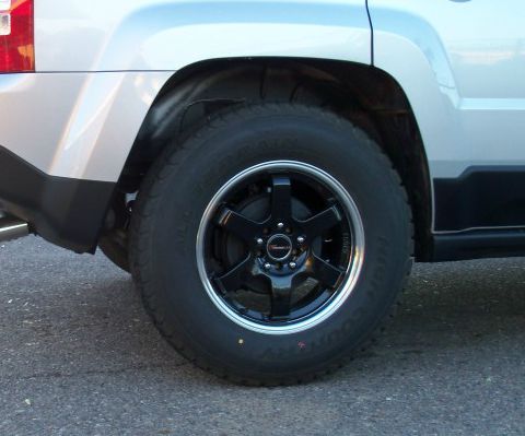

Any reason to whore out some pictures of my Patriot is cool with me!
The wheels are Mod Tech 229 16x6.5. I forget the ofset but I think it's the same as factory. In order for the center caps to clear I had to run 5/16" spacers in the front. I put the same spacers in the back just for conguency.
The tires are 225/75/16 Falken High County A/T. my Patriot has a RRO lift now but the tires didn't rub pre-lift.
This tire and wheel combo is only slightly heavier than stock but provided >1" of additional ground clearnance.
Pre Lift
Post Lift
Dirty

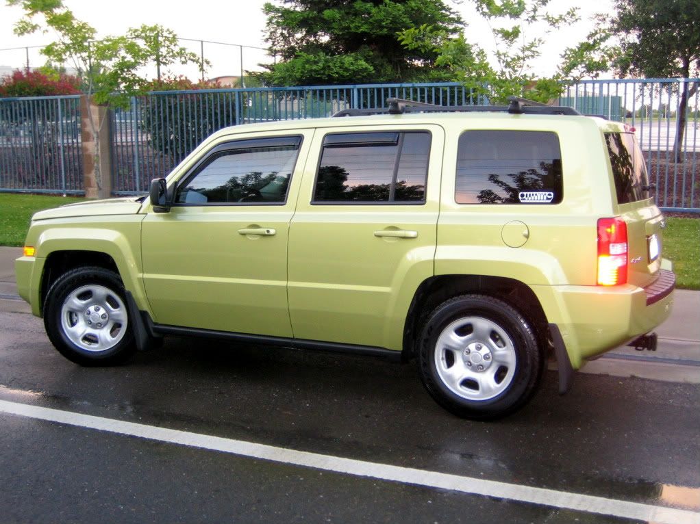

2008 Jeep Patriot FDII 18" Chrome Compass Limited wheels, 225/55/18 Hankook Optimo H727 Tires no rub

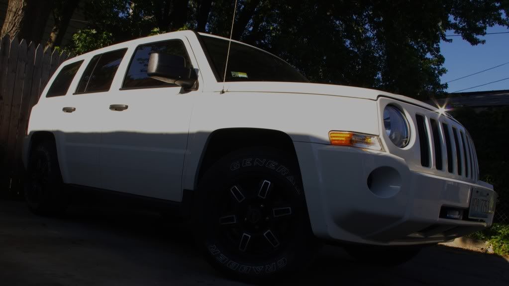

Here is my summer combination:
League 208 Nocturne rims (17" 8J ) with general Grabber UHP 235/65/17.
