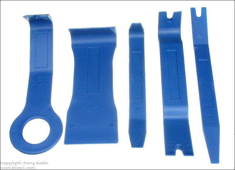

I have a kit like this (mine is red)
They are nylon reinforced plastic prybars and they work well.

Thanks Metaxa!! Where can I get this pry bar set as it would be handy to have in my tool box?

Ya, SpaceJeep, Princess Auto for you easterners but watch out, regular price for a good set, nylon reinforced plastic not just plastic is around $35.
But, they go on sale a lot. Or often...whatever.
I paid $14 for mine, down from $35 just before summer last year.
And a little secret...I often ask if the last sale price is in the computer POS machine and if it is I ask if they would be prepared to sell me one right now for that sale price.
Haven't been turned down yet.
I'm not poor, just cheap, eh?
#26 · (Edited)
Princess Auto sells a set of 5 for $14.99 and its reinforced nylon.
