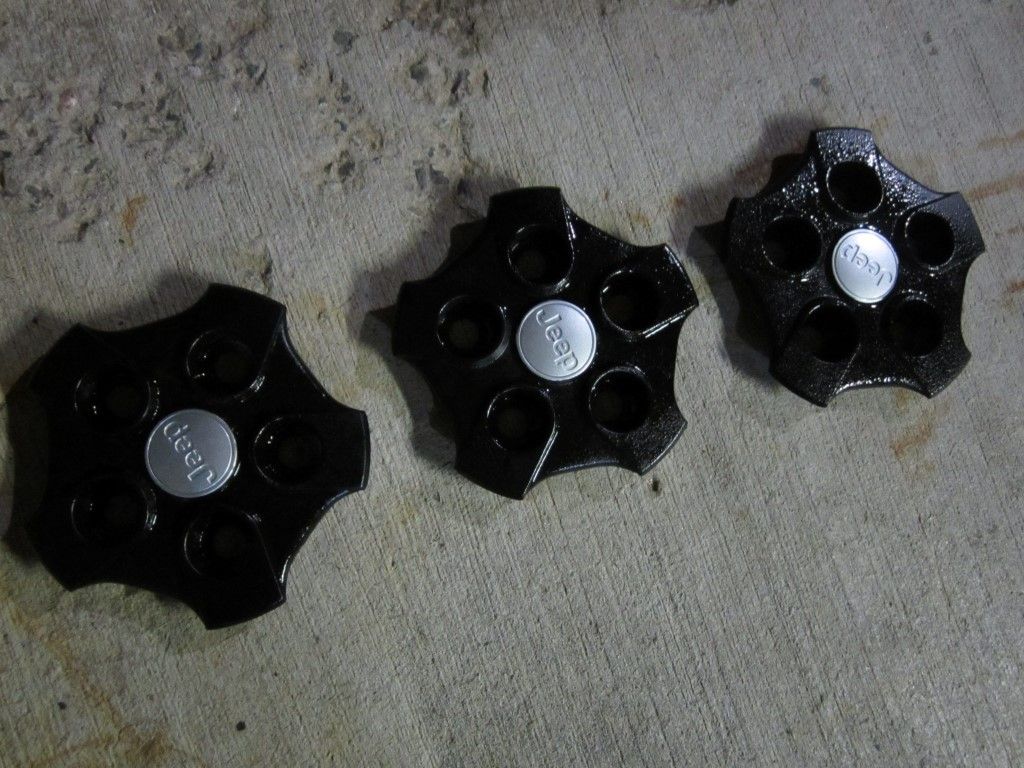

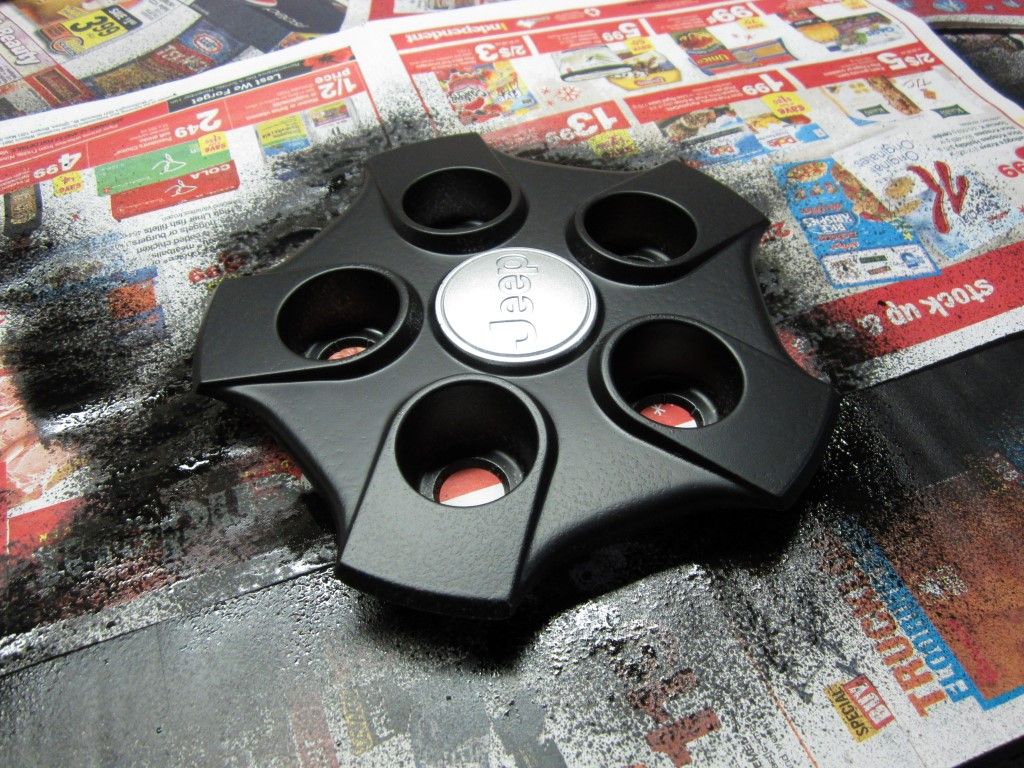

I didn't want to take the extra step in taking the wheel off to dip them so I just sprayed the hub caps and trimmed off the spray from the little circle center cap leaving the only chrome visible. Only to find out that the stupid metal tabs that hold them on was the cause of excessive squeaking!! Very annoying and loud.
Soooooo I used traditional dip and put a nice thick coat on the tabs and now they don't squeak. Ahhhh what a relief!.
I've used electrical heat shrink to solve the annoying squeaking problem.

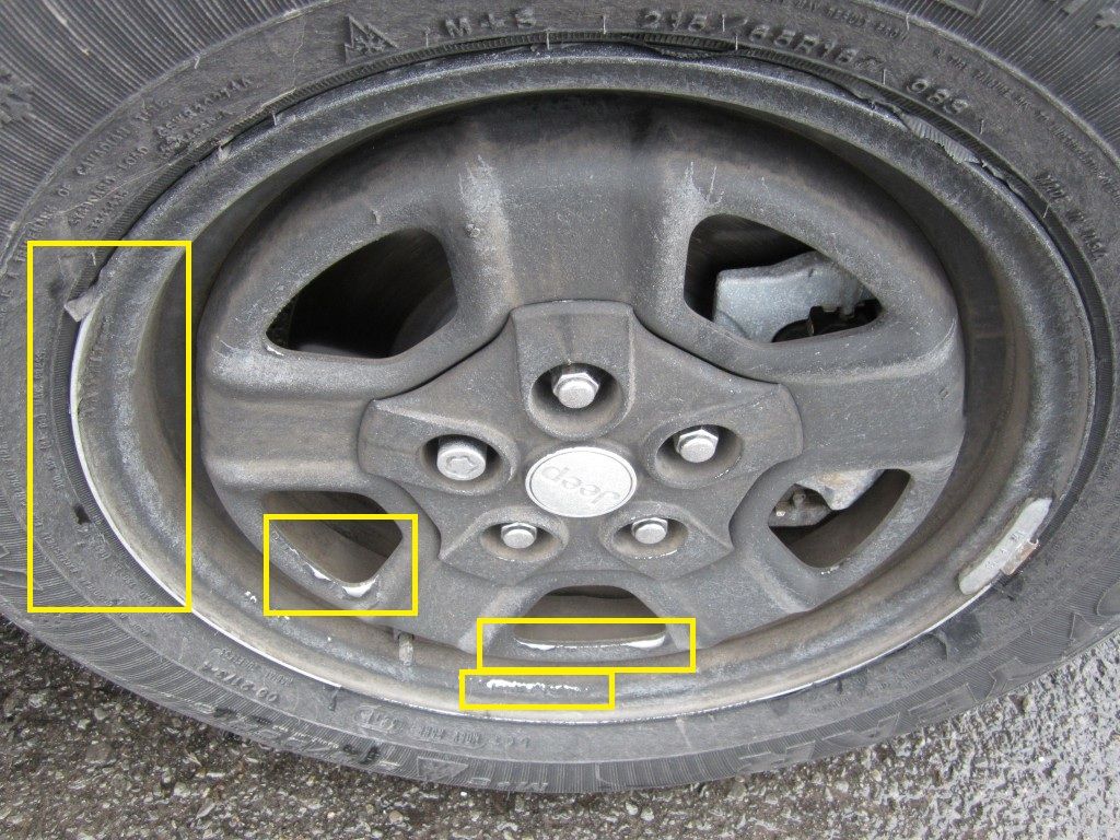

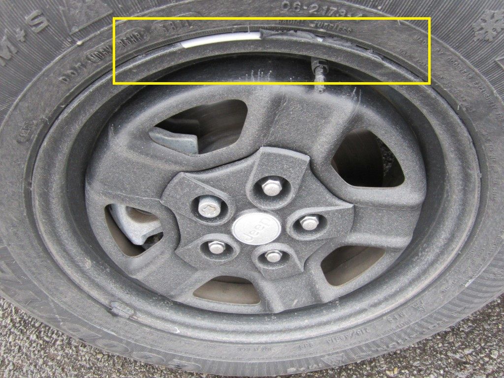

So here's what the dipped steelies look like after a long, hard Canadian winter. They are OK from far away but not so much up-close.
They were plasti-dipped just before I put the winter tires on back in November.
And this is what happens when you don't park all the way at the end of the parking lot when you go shopping :doh:
Damn that sucks man :/ did you dip them before they mounted the tires? I'm sure that didn't help the edge of the rims. Maybe next time put a few more coats on? I am sure though that it'd be very hard to keep them looking very good with the Canadian winters as you already stated.
No, dipped them after the rubber was mounted.
Can't leave 'em this way so I'm thinking that if the dipp cleans off nice, their getting a couple coats of Bed-Liner.

Ya, Kenny, up here the snow and ice gets plowed and it leaves ridges and ruts that are just like riding your rims up against a curb...unavoidable but hard on Dip.
Claude...you know you don't have to peel and start over, right?
Just clean them off, trim any loose bits and touch up the wrecked areas and then a total overcoat, you are good to go next winter.

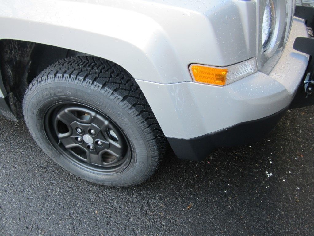

Installed my winter tires.
Decided to remove the Plasti-Dip and go commando. I even left out the little plastic caps, can't stand e'm... ugly little ^&%$rds!
Removing Plasti-Dip is easy on the flat surfaces, not no easy in the creases. Had to use the pressure washer to finish the job.
