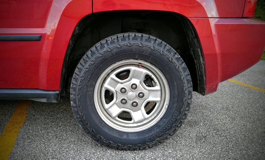

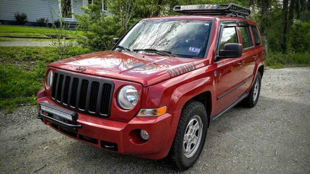

I guess I'm contradicting myself after all the comments I made earlier in this thread. Here is a picture of my 2008 Patriot wearing 225/75-16s. No lift. I had my doubts, but after doing a trial fit I changed my mind and figured I'd risk it. They came off our Wrangler (Wife did not like them) and I couldn't see wasting the rubber that was left. I did get a minor rub when turning while backing up on bumpy surfaces, like from my gravel driveway onto the paved road. There were some serious ruts there and the vehicle rocked so I had to take it slow. The rub seemed to be from the back but it was so slight I never thoroughly investigated. I never had any rubbing under normal circumstances. I'm a pretty conservative driver so the tires & suspension were never getting stressed at all.
