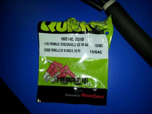

I am also going to try to find a better connector to the factory run/stop/turn input. The wire pulled out of the connector while I was switching back to the original red turn signals.
It will be a week on two before I have the parts and get back to business.
