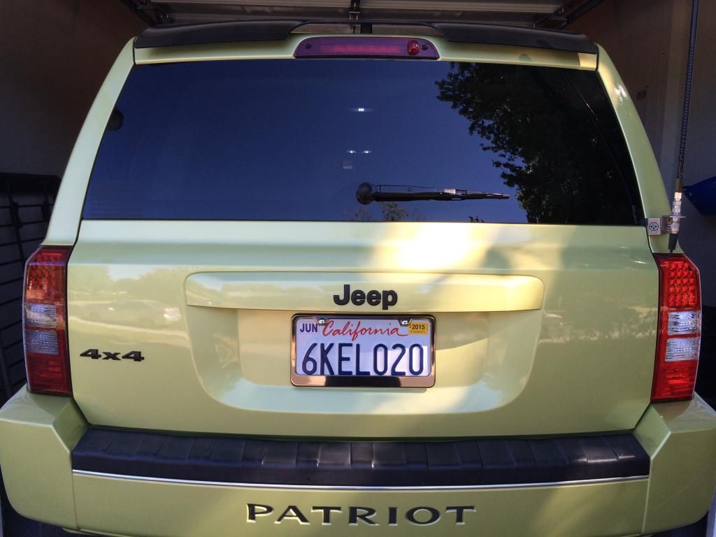

Here's my patriot about a year ago with the VHT nightshades:
Finally got around to doing the Nightshade on my tail lights. It ended up a little darker than I wanted, I did 3 coats. I also did the front turn/marker lights with 1 coat, nice smoke tint.

So since the taillights are darker now, I wanted to do something so people behind me could see me braking better. Our taillights only have 2 bulbs in them, but spots for 4 so I ordered another reverse socket and taillight socket for each housing. Drilled holes out and notched out for the bulb socket. Then I just tapped into the stock wire harness, and here's the results. (the new lights are LED)
