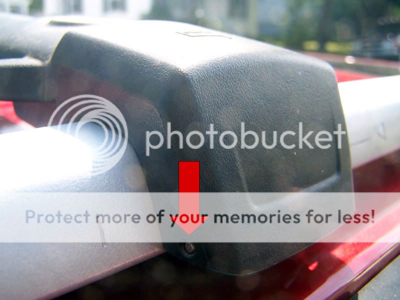

Locate position of retaining pin as shown below

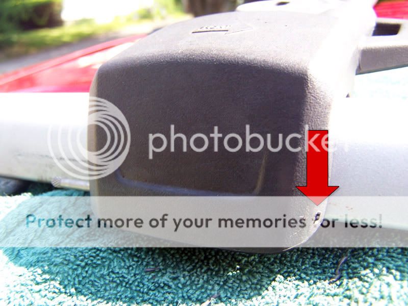

On opposite side of clamp, drill a hole at the same position as the retaining pin, as seen below
(I used a 1/8' bit to leave room for error in judgement of the position of the pin, but if you want to keep the hole smaller, 1/16" will be fine if you are exactly lined up with the pin)

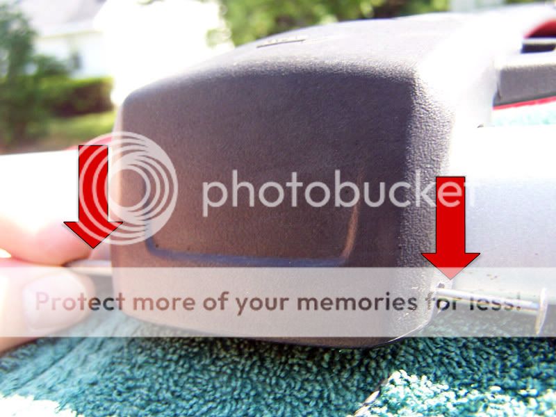

Insert a nail or similar object into the drilled hole and tap with a hammer to remove rataining pin, as shown below
(available nail size may dictate the size of the hole required)

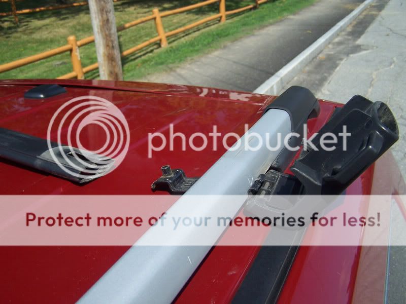

You only need to do this on ONE SIDE OF THE VEHICLE! Once the pins are removed and the clamps are taken off, the cross bar can be removed from the clamp on the oppposite side. Then just remove the knob from that side and the assembly will clamshell open without removing the pin, as seen below.

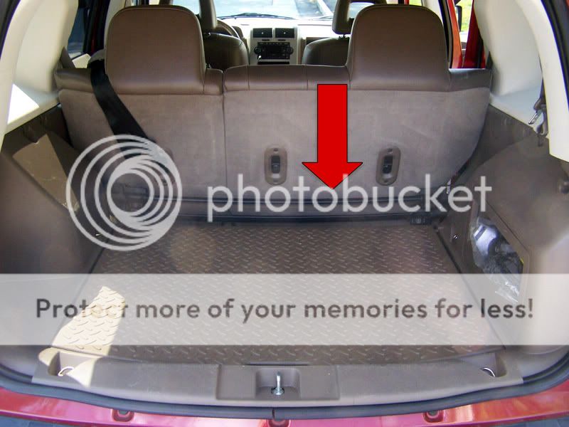

Once removed, I re-assembled the cross rails and stored them conveniently behind the rear seat, as shown below.
(they dont move at all under normal city driving conditions. No gaurantees for off road driving.)
