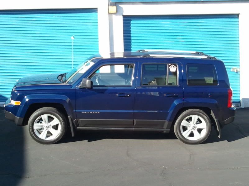

This next photo is with a similar but lighter load inside. Not the best angle for seeing how much rear sag there is. I bet those sumo springs would help my headlights stay angled lower if I have a full vehicle on a road trip or just moving cargo.
Those are a total of 30 boxes of bingo paper weighing 22lbs each. Total weight combined 660lbs for a very short trip to a storage unit.
My Compass suspension look very similar to yours with a 300 lbs tongue weight attached on it. It make sense because your load of 600 lbs is half of the weight over or in front of the rear axle.
