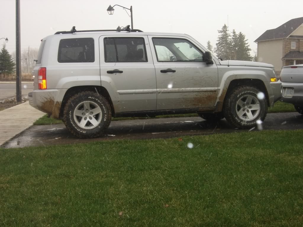

Although I just saw a Liberty with Moabs and 245/75/16 BGF A/T's, and it was a great look! His was lifted.
I have noticed a small decline in mileage however its been a small trade off.
I could not be happier with this set up.
BFGs are the best tire I have owned.
I have almost 80,000K on Riot 30,000+k with set up no issues.

At the rear of the front wheel wells, right near the bottom of the body, there's a hump in the plastic wheel well liners. That hump will be the first thing to contact the front corners of the tires when turning.
The plastic hump covers a metal ridge.
Hammer down the ridge flat and melt the plastic hump to make clearance for the 29.5"s.
Or put in 29"s (my plan - 235/70-16)
