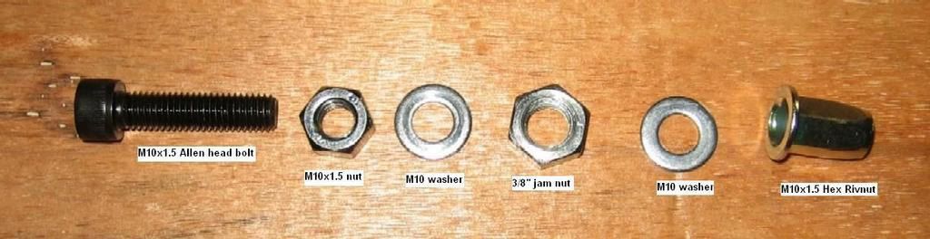

These are the tools that you’ll need. The shorter the 3/4" wrench, the better.
This is the pieces that make up the Assembly tool
This is it assembled. Where it says “lub” I used some wheel bearing grease but tried some air tool lub and found that almost anything will do. This is considered a “low load bearing” surface.
