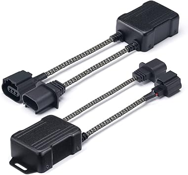

@MCMasterJ I recently converted over to LED bulbs and would never go back, it was quite literally day and night! I did run into the flickering issue that Shane97 mentioned, but the vendor recommended an adapter that fixed the issue. I find that the low beams have a cut-off similar to my halogens and the high beams are incredible! Plus the 6000K colour temp looks much nicer and more modern (I have changed all my exterior bulbs to LED now).
Here are the bulbs I got: https://www.amazon.ca/gp/product/B083GTH8FB/ref=ppx_yo_dt_b_asin_title_o05_s01?ie=UTF8&psc=1
and the adapter: CAR ROVER H13/9008 Decoder Canbus Resistor Anti-flicker Error Free Harness for LED Headlight Conversion Kit Warning (Pack of 2): Amazon.ca: Automotive
Both are on amazon.ca but you can probably find them on amazon.com too. Cost me just shy of $100 Canadian, certainly more expensive than halogens, but half of that was for the adapters which shouldn't need to be replaced, bulbs will last longer too. Everything is plug and play as well, except for a couple of heat sinks on the adapters that I mounted in the engine bay using self tapping screws and a little touch up paint to prevent rust.
Only issue I have is that my daytime running lights are now the full on, super bright high-beams. Anytime there are clouds or in the evening I usually just put on the parking brake to the first click to turn them off - still looking for a more permanent solution there. Since you're from the states you may not have DRLs though, so you may not have to worry about that.
