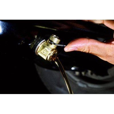

Buy a Fumoto oil drain valve, number F-106. Install that, and you won't have to screw around with wrenches any more.
