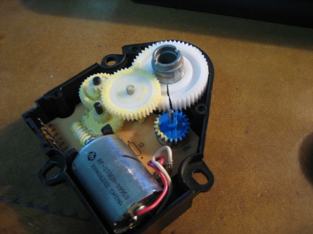

Turn ignition on and take a look below the steering wheel (upwards to gas pedal) and search for a black motor unit with a white arm and a big white gear. That's the blend-air door actuator. Now, turn on the A/C and move the temp knob. If the mechanism doesn't move while you change temp, it has stuck on 'cold' position. Gently move the arm and/or gear to free it.
You should now have hot air again and A/C should react to temp changes from the knob.
Excellent! I was experiencing the same problem and this fixed it! Can't imagine how much it would have cost to have this diagnosed.... Thank you!
