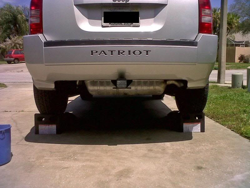

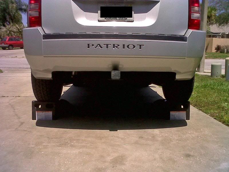

I finally did this mod. Used VHT header paint and it was great!! I would suggest spending the extra few bucks for this paint because it contains ceramic and is resistant to road grime. It went on very easy and dried quick. Pics later tonight...
I had to sandpaper off the built up road grime after I cleaned it off...then I cleaned it again after sanding and did 2 coats, which was easy since that stuff dries pretty quick.
here we are..sorry, kinda dark pics, thats what you get when you use a blackberry for a camera...
Ta da!!! dissappearing muffler!!! hehehe, looks much better, and the girlfriend even said it looked great. She said "he" got a "butt lift" hahaha
