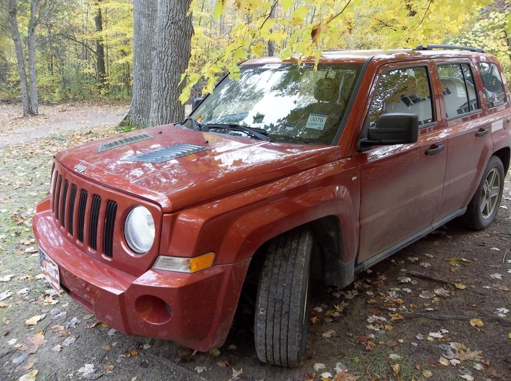

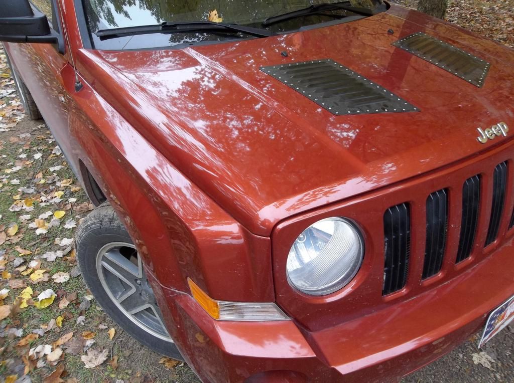

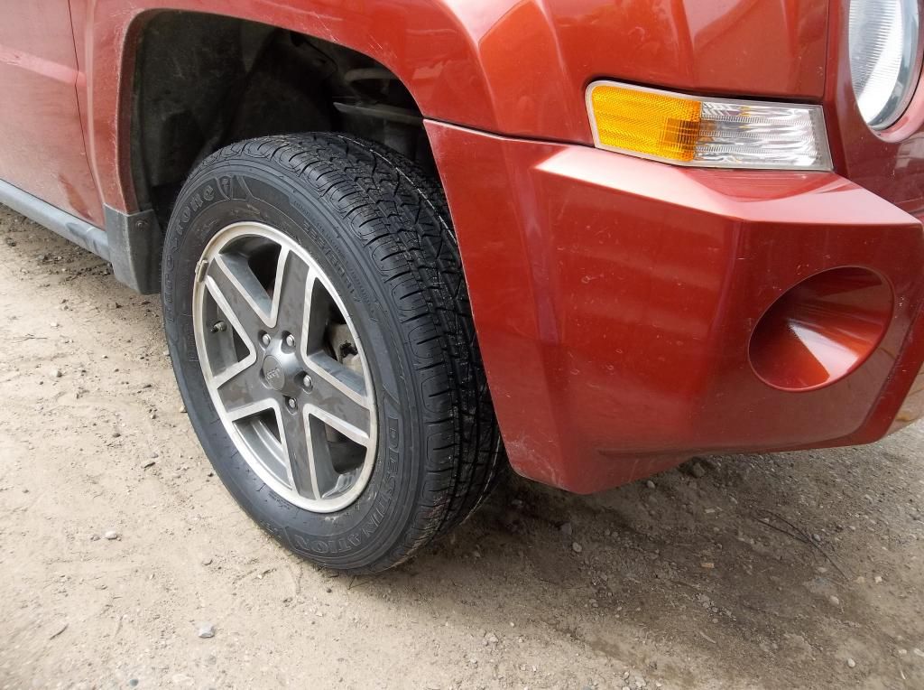

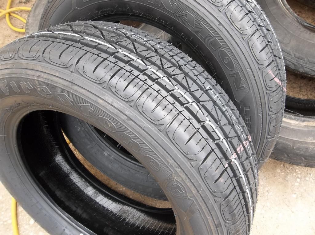

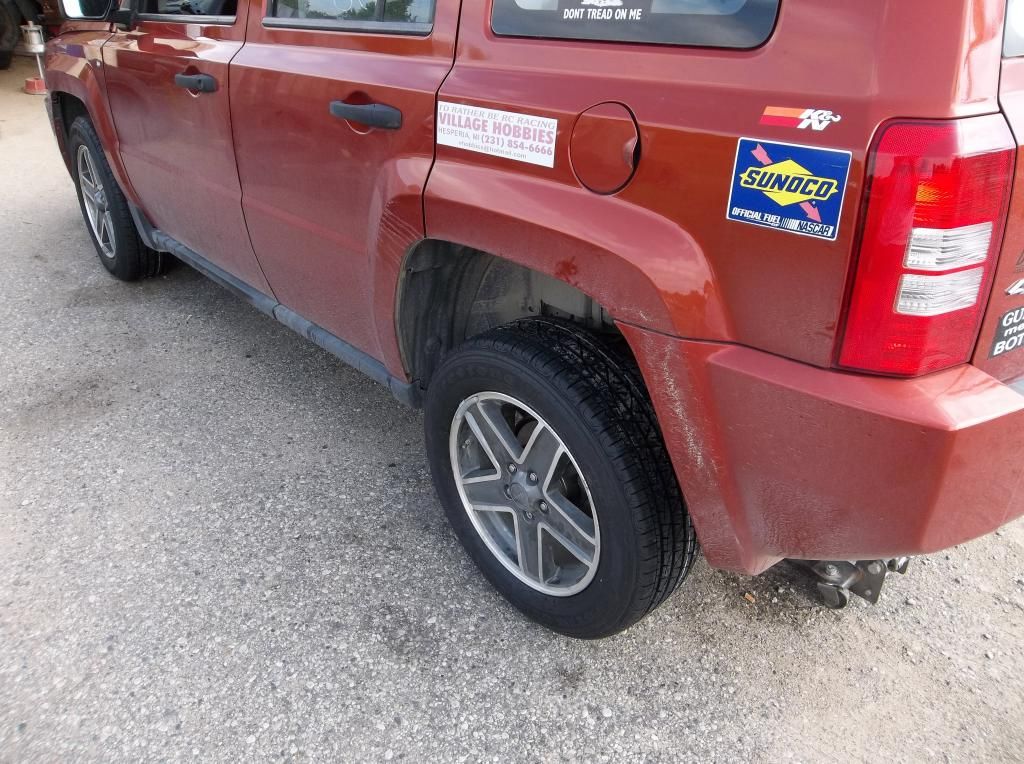

P225/60R17 has no rub on mine, and I think the speedometer should still be calibrated correctly. I have 1 centimeter of extra tread width on each tire, so a little extra traction, and they seem to work pretty well. Almost wierd to not have my low tire light come on every week or two, lol. Here's a few pics since I had 'em installed. Firestone Destination LE2, P225/60R17, x4.
Rossoraser I like the hood. Can you send some more pics in my inbox of closer pics and under.
