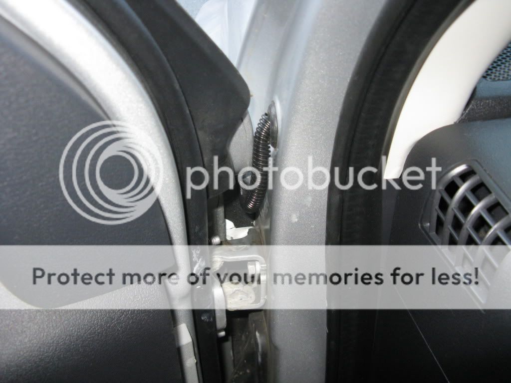

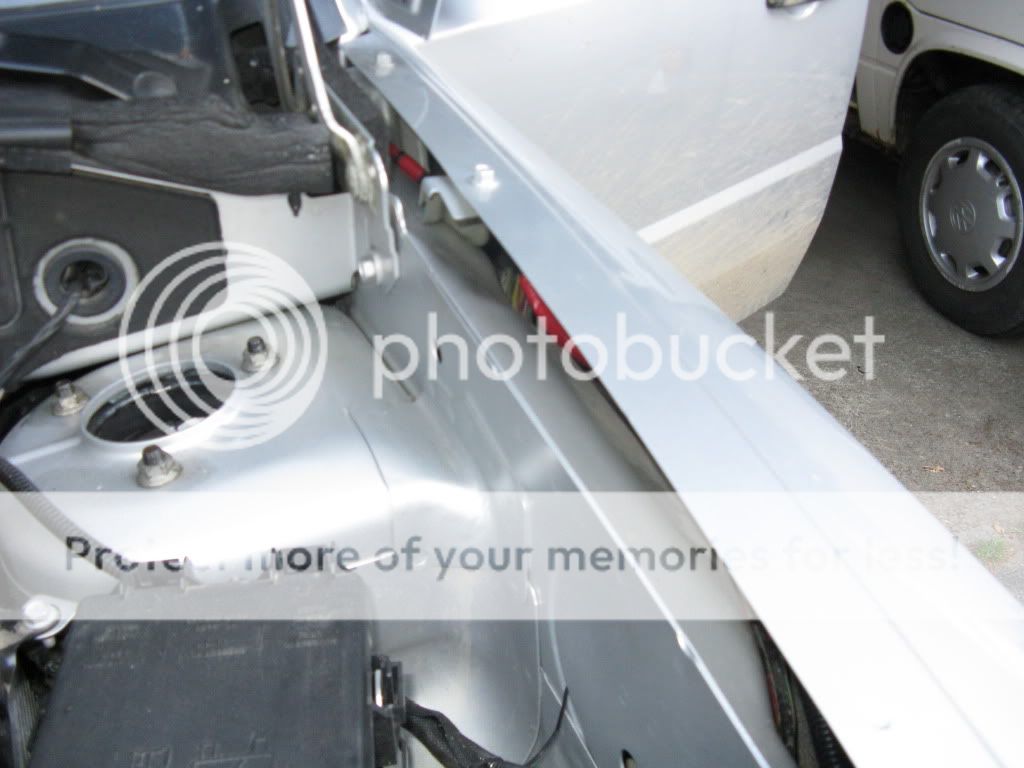

here's where I went, but if I knew about the wheel well grommet, I would have tried that first. My location you have to push the wires through foam insulation that's in the door pillar, and snake it up and then back down into the dash (the inside plastic has to come off the pillar)

On my 2007 Patriot I ran the light wires through the rubber grommet in the firewall. I drilled a hole to the left of the gas pedal installed a grommet and ran the wires throught the hole I drilled, then sealed so it would be waterproof. Beautiful photos, Heckler.
On my 2007 Patriot I ran the light wires through the rubber grommet in the firewall, they come out under the dash. If you are worried about water coming through the grommet, just put some sealer around it after you run the wires. I don't know why in the H you would want to tear everything apart when you don't have to. Its called work smarter not harder its a no brainer in my opinion. Check it out, unless there isn't a grommet on the 2010 but its probably the same as the 2007., the wires come thru under the steering wheel. Open the Hood and look at the firewall, its right there, you can't miss it, so simple, a blind man could find it. Beautiful Photos Heckler, I wish I could get my photos to come out that good. I'm working on them.
