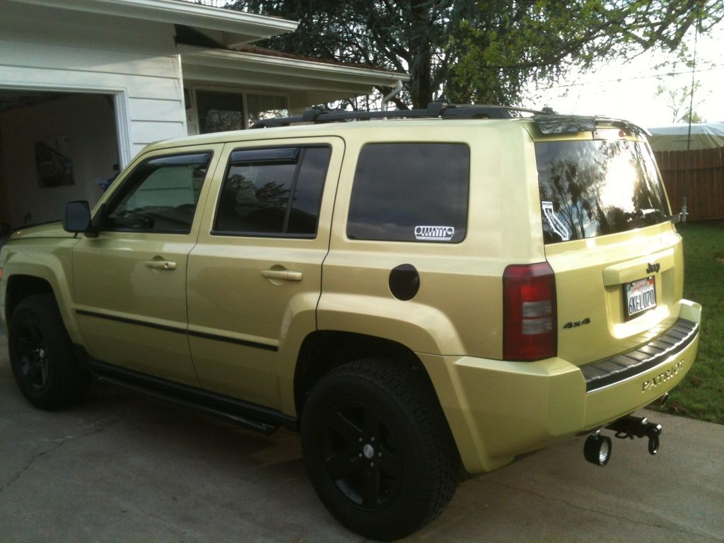

I PM'd him, asking if there was a how to on those front shackles...no answer as of yet so he may be away or busy or...
I'd like to know how he got those attached too...
