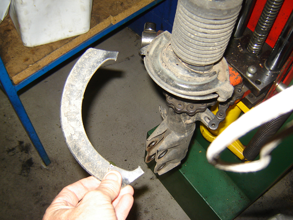

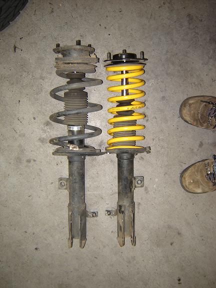

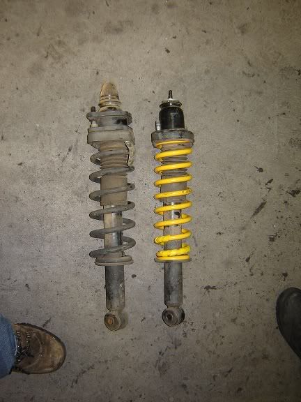

ok here are some comparison piccies, we will be doing a full comparison report soon, reason for the delay is we ran out of time to do a proper alignment. one thing we have found and waiting to confirm but is seems that 2007 models may actualy be lower as the results for the changeover are identical so a spacer lift the same as a spring lift, but i am waitng for confimation on measurements, one thing i can say is handling has improved dramaticaly...more to come
rear RRO on left
removed extra bit which allows for larger tyres
rear with padding on springs
front RRO on left

In relation to another benefit of my coils Vs a spacer lift, the spacer lift will actually make the car hit its bottom out bumps stops quicker than the coils as the mounting point has been altered, not the encaptulated travel inside the strut. That combined with the soft uninspiring spring rate of the stock Pat coils makes for a questionable ride imo. I've spent many years in the Suspension Industry, I've designed coils and shocks for a living once, and am now back doing what I love! I'm about to revalve some OME LTR shocks for a WH/K grand cherokee to tune them for a specific ride.

Zbee if you read this post - was there any reason for the padding on the rear coils in your post and if i were to get them what exactly am I looking for :confused:
