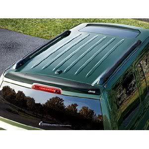

I ordered Mopar rear air deflector couple of days ago. I finally found one for a decent price $66 shipped :pepper:. It should be here any day. I'll post pics once installed.

someone is selling stu coils in the outpost if you are interested. also it look like the rear air deflector is facing backwards (like it will be less aerodynamic)

Here are some take a ways from the installation. First of all, look through the brochure it came with, make sure all pictures make sense. Second, make sure you have 17/64 (7mm) drill bit. If you don't, go get one. I used the smaller bit first and then 17/64 to make the holes bigger. I used regular silicone for riv-nuts to prevent any rust. I found the riv-nut tool it came with pretty useless. The entire installation takes around hour and a half if you have all necessary tools handy. I'm pretty happy with the way it came out.
You did a nice job, I think it looks great. Nice Photos, I would like to see a photo from the back corner down the side. The rear deflector probably matches up real nice with the side window air deflectors.
Very nice! Did you have to move the roof basket forward?
Thank you! I didn't have to move the basket. It still sits as I put it 6 months ago.
