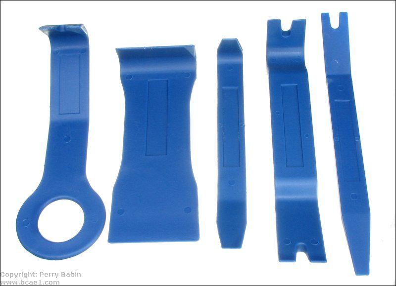

I highly recommend a trim removal kit, look around, they are inexpensive.

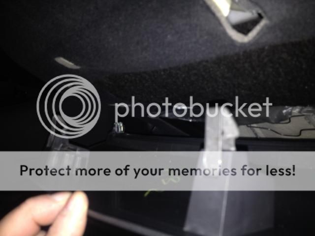

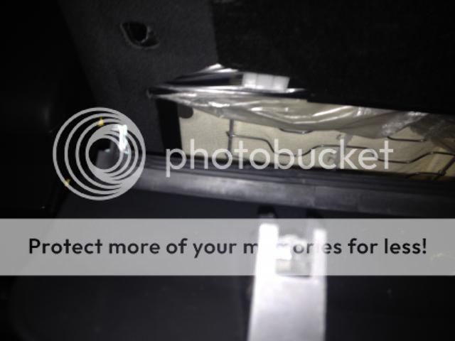

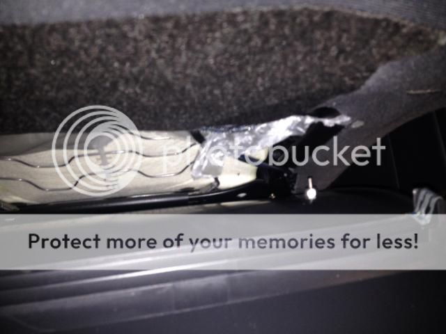

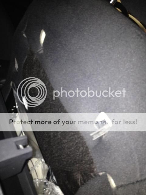

I pulled the seat back halfway off today to bolt on a map pocket. There were two clips on top and two on the sides at about the mid point. The top two clips came out of the plastic and stayed in the seat. They had to be pulled out and set back into the plastic back before inserting the back onto the seat.
Clips pulled out and still hanging in the seat:
Drivers side looking down:
Right side looking down. Notice the wire along the side.
