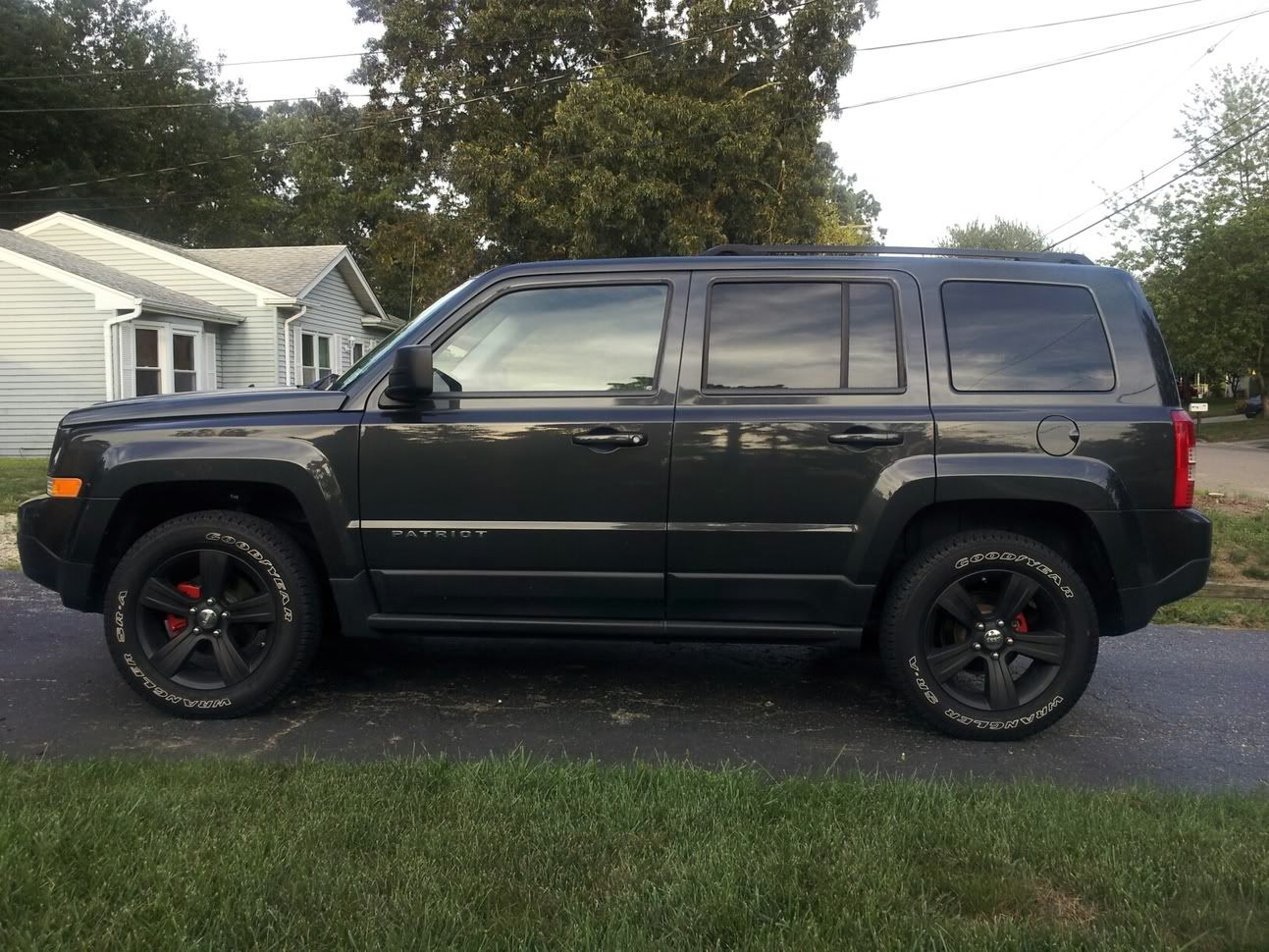

This was my weekend project....whatya think?
Got 1.5" wheel spacers on there, as well.

Looks better IMO
And.....I like the look. Looks real nice! I'm looking for the stock aluminums myself. But I want them gloss black.

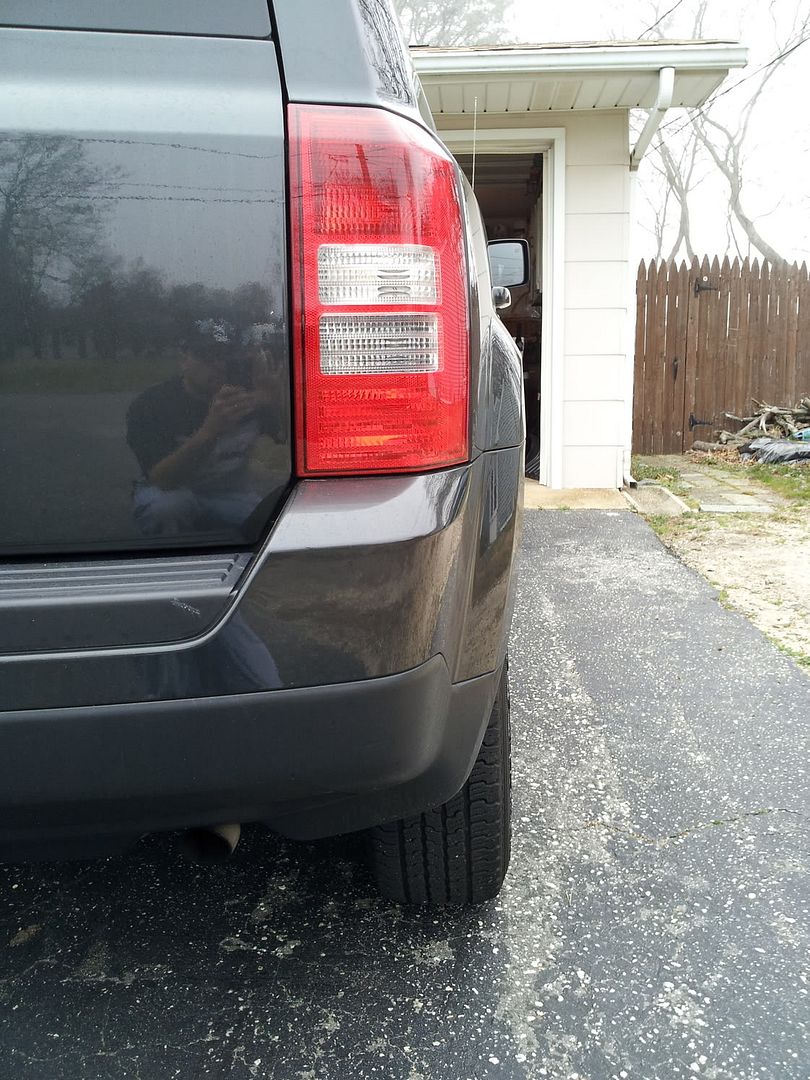

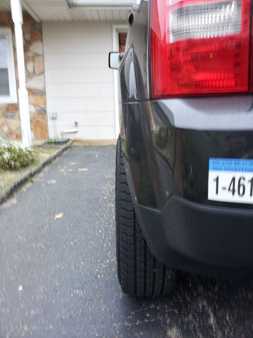

I would love to see some pics of how far the wheels stick out from the fenders. Did you take any shots from the back? (No ****...:D)
Here ya go...
Before..
After..
These were taken before I painted the rims and calipers.
