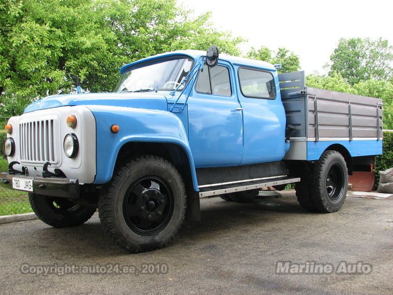

I took my driving lessons with old Soviet cars with manual transmission (with them you could not rely on anything, really), therefore I was teached always to turn the wheels out, to the right (away from the road) when parking on a not-horisontal land. If the parking brake would fail and the stopped engine could not hold it, the problem would be minimum this way :)
