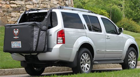

I want to add another storage - Rightline Gear PackRight Cargo Saddlebag
I wonder if I will connect it to the rail or the cross bar if it will be safe to have the basket with 50K and the Rightline Gear PackRight Cargo Saddlebag with another 50K load. (I do not have hatch down)

Just so everyone knows what you are talking about.

But I do not know how much take the side rails and if I can load both in once the basket on the roof and the bug from behind like show in the picture above :)
