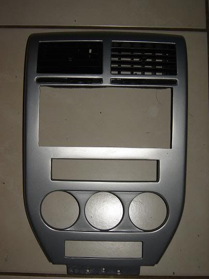

Seems to be some skeptiks, the unit i have is a REP which is a MYGIG, Australian version, and by using the adaptor 99% of functionality is achieved, the only main issue is the clock, as the mygig does not have an internal clock and is designed to get clock data from the car, the newer canbus networks so called high speed have a central system clock, expecting all parts in the next week, the center console will jhave to be moded for the factory look, which isnt a biggy...btw i won the mygig on ebay for the ridiculous price of 600aud so im ahaed anyways;)

as i dont have sirius in australia i would assume that extending the cable shouldnt be to hard, i suggest talking with a car audio place, as to the bezel, i am modifying the standard bezel(chopping) as the nav bezel is to big and a custom surround would have to fabricated, i will post pics soon as i have not recievd the lockpic adaptor yet and im still sanding etc the standard bezel to see what the results will be, i have a fall back plan on fabricating a surround for the nav bezel as well, so i can compare the 2 for all to see aswell

i have both bezels and also the above kits, unfortunatly in all cases none will fit suitably, the dimensions of the mygig is about half way between both center bezels, to me modding an original will give the best results, but i am going to do a bezel plate for the rec bezel aswell so i can give comparisons for all to see;)
