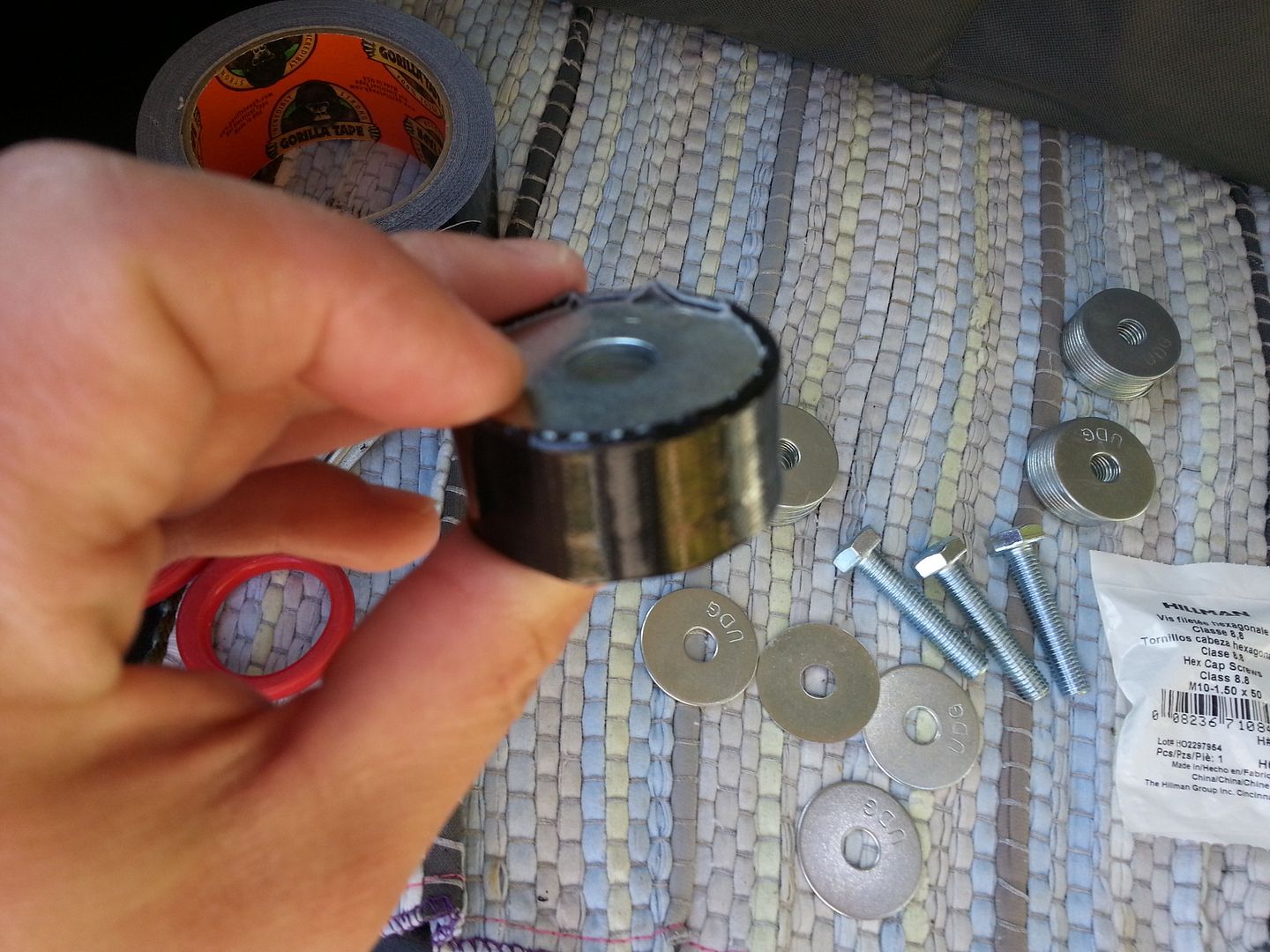

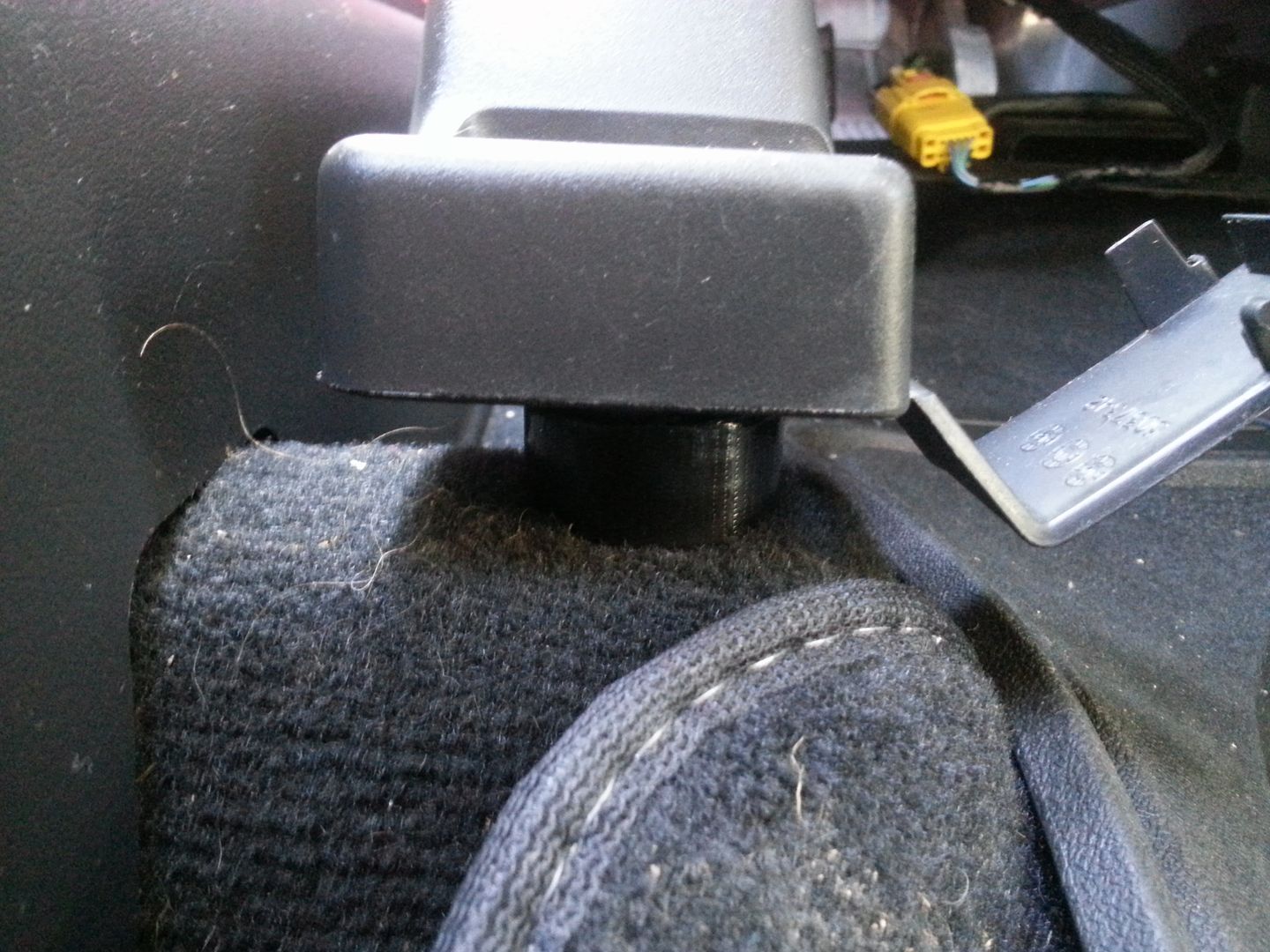

I added 3/4 of an inch to my driver seat using washers and longer bolts, I thought I would add this to my build instead of doing a write up mainly cause you never know if something like is completely safe, I got the idea from reading other members posts but there were never any pictures, and god forbid I do a write up and someone get hurt...so If you read this and attempt to do it yourself know that to my knowledge it has not been tested in a crash so you will be doing it at your own risk...I also encourage you not do it unless you take full responsibility if something were to fail in a crash...do not try this at home! Lol now that the disclaimer is out of they way...

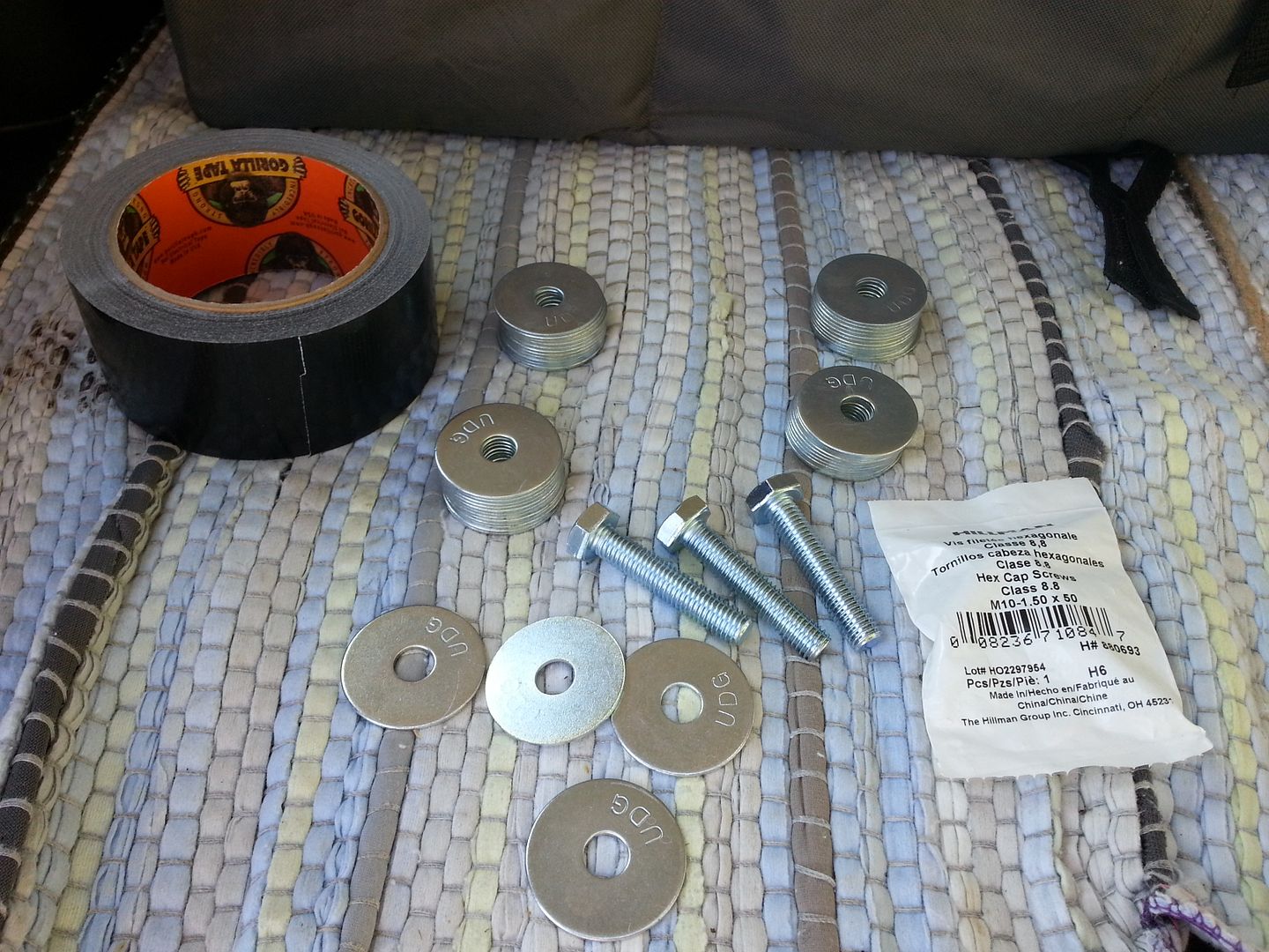

I had ordered a 4 way seat with height adjuster from a junkyard 300 miles away from me. The total cost was going to be $272 to my door, after about a week of them not shipping it and me thinking about how much I spent on it, I couldn't justify spending that much to raise my seat maybe an inch and a half. So after reading other posts I decided to use washers and longer bolts to raise my seat up 3/4 an inch...total cost $16.00
Here is what I used.
I wrapped the washers in gorilla tape.
Took out my factory bolts and put the washers under the legs of the seat and replaced the bolts with the longer ones.
Before
After
Good job including pictures! I like the idea, however if you can, try to switch out those zinc bolts for a Grade 8 bolt. Great 8 has an extremely high shear weight and they're not that much more expensive. The trophy trucks in off road racing use grade 8 to bolt their seats down, if it's good enough for their application, it'll by all means be safe to use in the patriot!

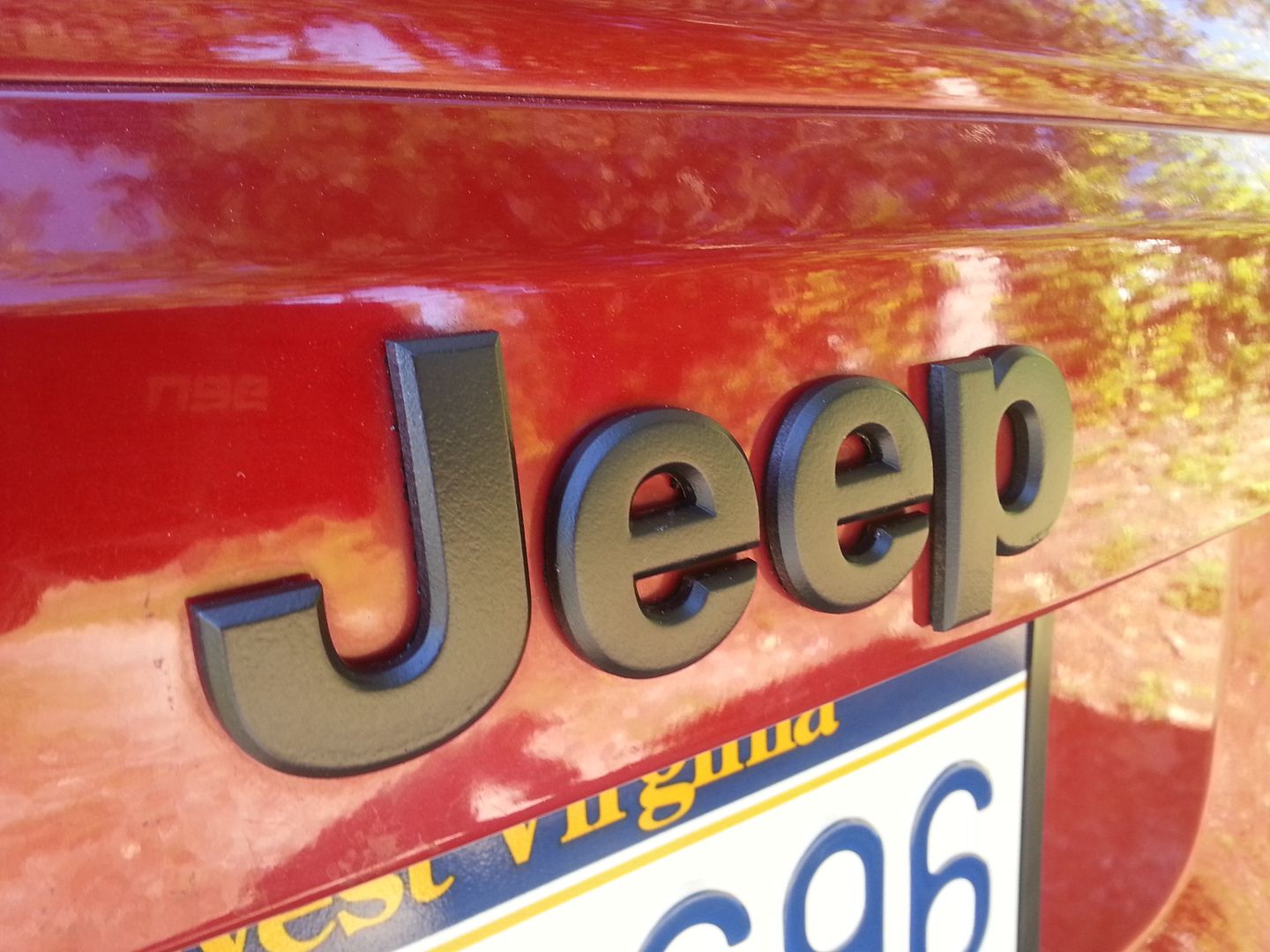

I believe there's stickers available that fit inside the lettering, but I think a few have carefully used the 'dip on it too. My current bumper doesn't have the lettering. Slight disappointment when I first got it, but it's a pretty clean-cut look and helps folks automotive IQ if they've got a mind to learn, lol. Been mistaken for a Liberty once or twice, haha.
