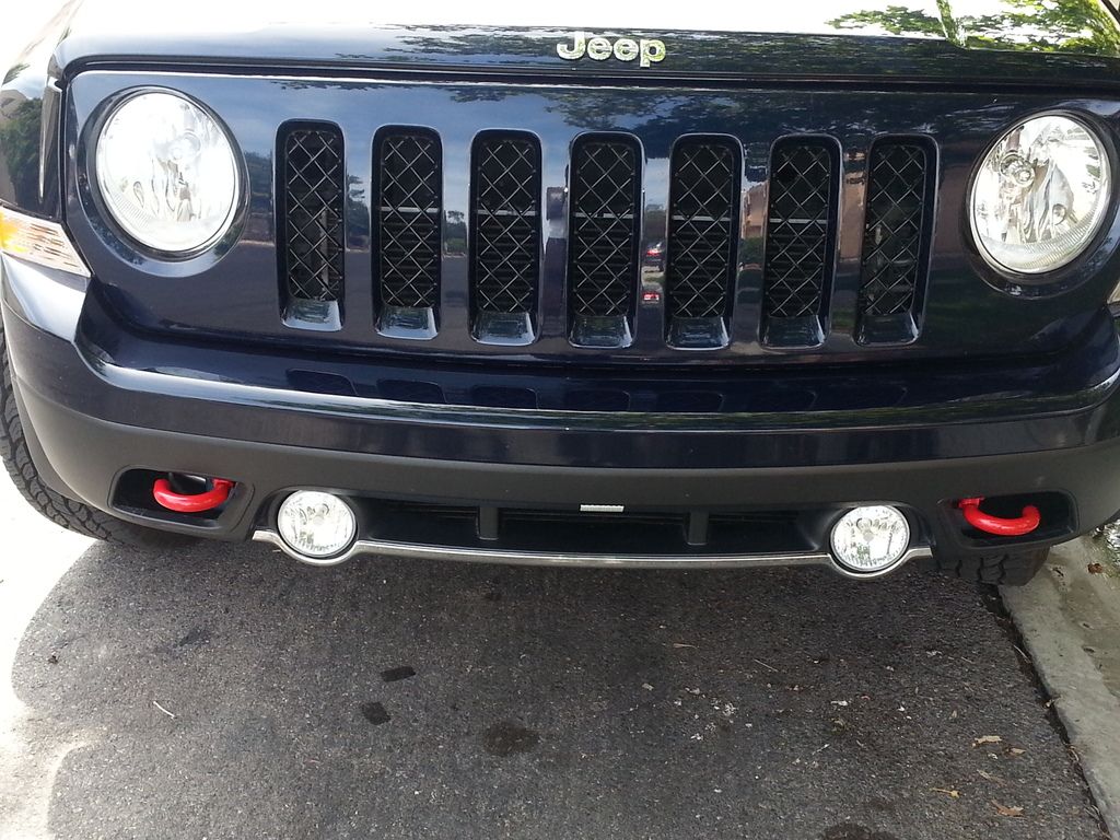

Bought these on eBay for $173 and got them Powder Coated Red for $80 About $255 all together.
Part # 82212577
Ordered some tow hooks and will try to explain how I installed them.... Enjoy!!
First I got them Powder Coated in Bengal Red.

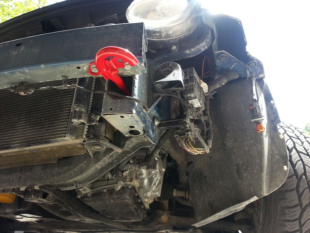

First I removed the bumper cover, plastic skid plate and fender liners were loosened and moved out of the way.
Then the cutting starts!! Kind of a hack job with my cheap dremel. However with some touch ups it cleaned up nicely.
Here's all the hardware I had to remove to get the bumper and skid plate off.
This little silver piece where the bolt goes into was a slight pain in the butt to get in there. The lower radiator hose was in the way making it slightly difficult to wiggle into there. Got it though after a few minutes!
Once the bolts are tightened up I just put the bumper back on and cleaned up for some photos!
These are the pieces I cut out!
Hope you all enjoyed my quick write up, I will revise and edit this later on when I think of stuff I forgot to mention.
Overall a pretty easy installation. Please post with any questions or comments! Thank you all for posting photos of your tow hooks which I found while searching on how to do it! This is a great community!
Nice work, mine are actually at the powder coater as we speak.
For mine, Im replacing the fascia with one that has tow hook provisions rather than cutting it though. But looks great!
For mine it's two separate pieces but they are snapped together with plastic clips or something like that. Seemed a little difficult to separate them so I left it alone.
Much faster to take the whole assembly off, idk if you could even get your hands or tools in there to separate them with it attached. Nice job!
