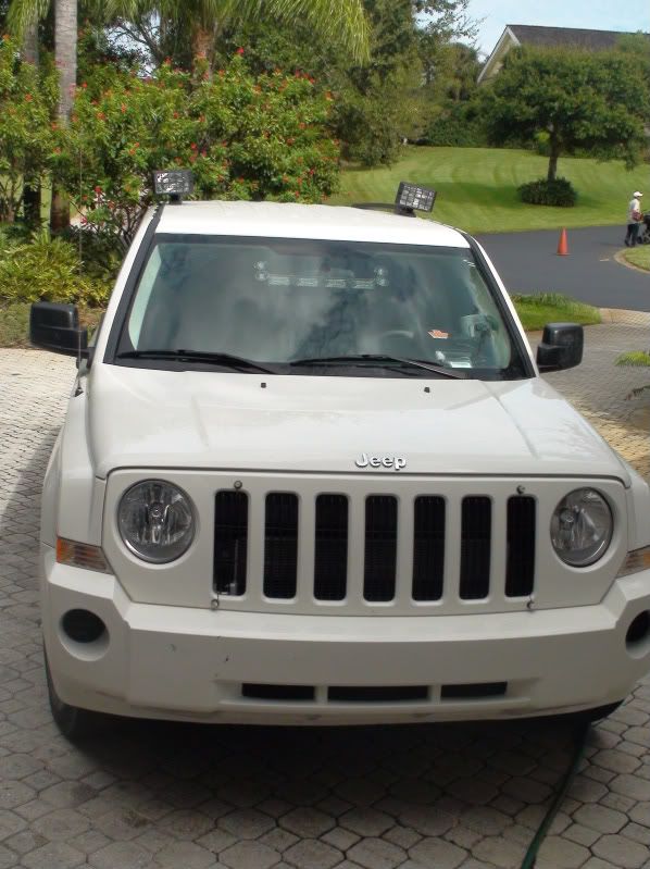

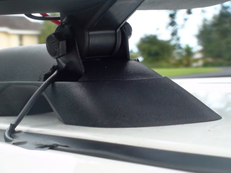

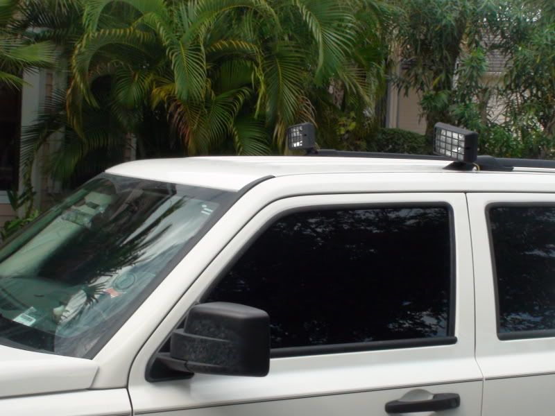

I sacrificed my son's patriot to lab-rat duty while he's away in Mexico before he goes to college.
Pictures:
Still to come: night shots.
EDIT: His windows are super tinted and the mini-light bar suction-cupped to the windshield are all work-related.
