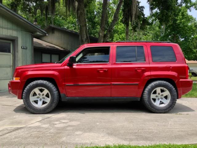

here are some pix at stock height w 245/75/16 on Rubicon wheels. I have since installed the RRO kit and beat in the pinch weld on the back side of the front fender. My tires have around 50% not sure how much another 1/2" of tread is going to change much. I do not rub at all since I beat in the pinch weld. The RRO kit does nothing to add more room to the wheel well. The vehicle would have to come up 6-9" from stock to change the location of the wheel enough to put anything larger than a 245/75/16.. I think this is the limit. I will say after the RRO lift this is the perfect wheel, lift, and tire combo this vehicle should've came with from the factor.. You also loose 10% on your odometer and speedometer, but with both the lift and tires you are 4" over stock.
current pic as it sits today
Those are some big tires.
Pretty sure those are the biggest tires I've ever seen fitted to a Patriot. I'm sitting here wondering how driveable it is with those.
When I went to a 225/75/16 on my Patriot I was having to drop down into 4th gear on the highway all the time to keep up with traffic because of the added height & weight... and those are at least an 1" taller and have to be much heavier.
Let alone if you had a blowout at highway speed. It would tear your fender right off!!
Attached is another patriot running a 245/75r16 BFG KO2.
Go big or go home! ?
