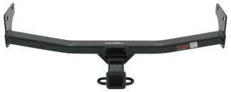

How does the class 3 Hidden Hitch compare to the Curt. Sounds easier to install, but not as strong.
Easier to install (by 2 bolts), and not as strong, though the strength is more than the Patriot is able to handle anyway (unless you are pushing a high tongue weight).
That being said, a few of us have chosen the Curt for the simple reasons that we could get them cheap (I think I paid $130 and it came with the drop/raise bar? was cheaper than HH/Reese for me), they are a little sturdier (even if you don't need it, it is peace of mind), and just in case we load the tongue a little heavy (such as with a cargo carrier).

Eh, loading my brother's moped and a cooler or two on my cargo carrier makes me happy that my hitch is rated at 400lb tongue weight instead of the 350lb.... My cargo carrier is rated at 500lbs by the way.

I wanted to be able to carry heavy objects that didn't fit inside my vehicle. I looked at hitches. The Curt hitch was rated at a higher tongue weight (which equals greater allowed loading) and was cheaper and included the drop bar. It fit my needs best, so I bought it. Other people were happy enough with the lower tongue weight, and didn't want to be bothered with enlarging 2 holes, so they bought the other hitch. Nothing wrong with that either.

Regardless of whether the hitch is rated for 350lbs or 400lbs, both are substantially more than the max set by Jeep.
Page 307 of my owner's manual shows the Max Tongue Wt as 225lbs with the Trailer Prep Package, otherwise it's only 150lbs.

Like Butch, I bought the Curt hitch for value, good quality and great price. $124.95 w/shipping and a ball mount included in the price.
But, I only did a 4 bolt installation for ease, so I ended up with "standard" hitch strength and paid much less than I would have for any other hitch and ball mount at the time.
If I want, I can install the other 2 bolts if my needs change.
It was the best option for a hitch at the time PERIOD. The higher tongue weight rating was just the icing on cake for me.
My Patriot is not an offroader, but for those who are and use their receiver as a recovery point, I sure as heck think they'd rather have a hitch attached with 6 bolts instead of 4 to distribute the strain over a wider area of the "frame".
