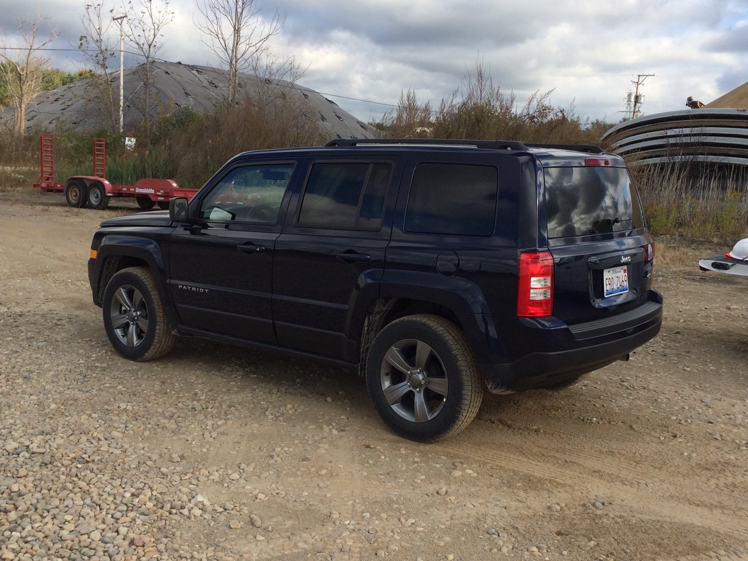

Spacers are installed. Cleaned off hub used small amount of grease on the hub ring. I used anti seize on the backside. Used red thread lock on studs attaching the 1.5" spacer. Torqued spacer to 100 lbs. replaced wheel and torqued. Have my Goodyear SRA 215 65 17 on now. I am going to decide which tire I want to buy. Any recommendations? I want to do some light trail driving soon. Nothing to major just want to go have some fun.
Before
After
