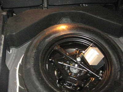

    For those like myself with the Limited package who have factory Sirius (tuner P/N 05064075AD) and the Boston Acoustic audio package with sub (Kicker amp P/N 05064118AJ), you have to remove the spare tire cover and then the soft mold foam cover to reveal both items:

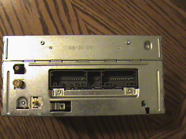

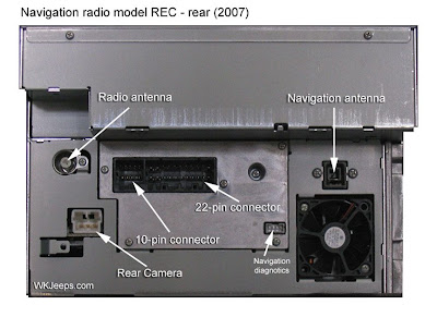

  • The Sirius is connected via the 10-pin connector on the back of the REC unit. This should make for an interesting time in extending the antenna plug from the rear driver panel to the headunit.
  • The navigation antenna (P/N 56038630AC) is square (link), while the one on the back of the RER unit is circular (link)
On top of that, I found out another little nugget - there is a bracket (aka Radio installation kit) (P/N 05291823AB) for the REC, and with the RER being smaller I'll probably have to hunt down a part number for the RER (or possibly even the REN) so it's in the dash nice and secure.
