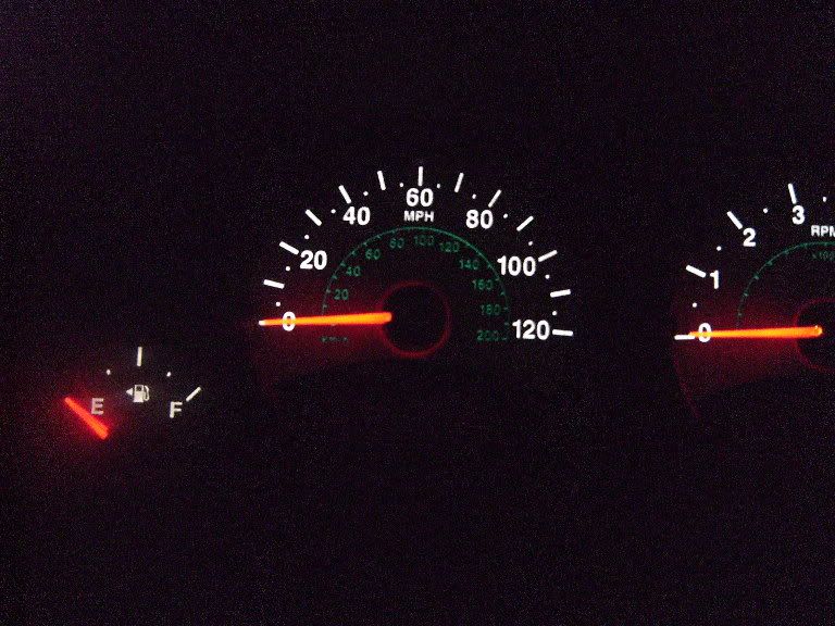

Here is a pic of the gauges in the dark. Could only get part of the gauges because I had to steady the camera on the steering wheel. My camera takes shaky shots in the dark.
18 Posts
I don' see any difference in the dark, but looks good as well.
