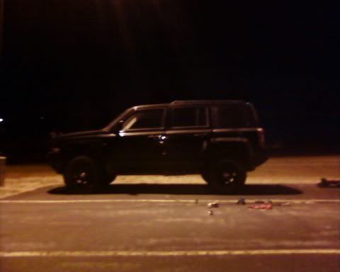

Of all of the members here that have RRO lift equipped Patriots, how many have installed the kit with their own two hands?
Just finished her off February 08, 2009 after midnight in a military parking lot. 44 degrees fahrenheit, 15 mph winds from the northwest, hand tools and a flashlight.
