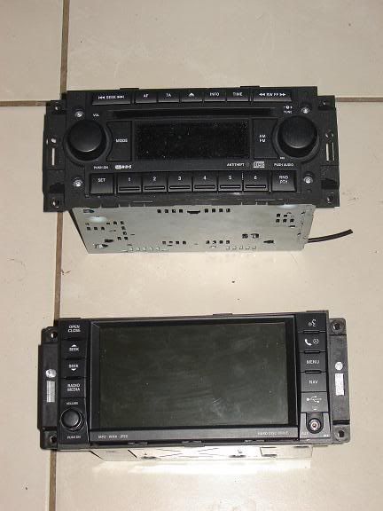

ok, bassically you will need a mygigoff ebay) must be a "LOWSPEED" version can be nav or not there is a knowledge base here
http://www.wkjeeps.com/wk_nav_2.htm
and here is a good mygig software and knowledge base
http://www.mofv.com/MyGIG/
and most importantly you will need one of these(note i had to get wwwade to get one for me as they dont ship outside the USA at the moment)
http://www.coastaletech.com/MYGIG_ADAPTER.htm
i suggest you also get the microphone kit and multimedia cable from them aswell
i used after market cameras for both front and rear.
the mygigs dimensions are half way between the standard and the RECtype bezels so i used a dremel and sandpaper etc to mod the standard one, the hardware instalation is very simple and straight forward, the instruction sheets are very simple and clear so i wont bother writng about that side of things. it is strongly advisable to discontct the battery initially so when you power up all goes well, when first powered up the mygig defaults to a chrysler screen but then changes to jeep.
comapring the standard radio and mygig
rec bezel andmodded standard bezel
mygig in patriot
front camera stuck on with velcro hehehehe
i masked off the standard bezel and carefully used a dremel to cut out, the template that come with the instructions will help with the height the width is bassically along the edge of the curved cutouts, measure twice cut once is very much needed here, i sugeest you remove the metal clips so alignment can be done with the mygig and the bezel to check the cutting out procedure, all functions work fully;)
