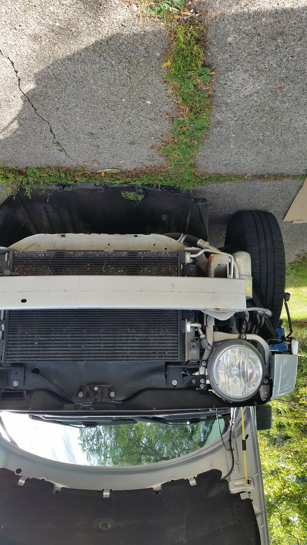

Ok, maybe my only post because this isn't my own Patriot but rather the fiance's.
First post because this section was SERIOUSLY lacking photo support of said radiator flush, lol.
I did end up taking the bumper off and removing the bottom splash guard. Sorry, no pics of the splash guard since that one is pretty self explanatory, but here are the bumper ones and where in fact the petcock is located.
I did in fact use the Zerex G-05 since it was recommended by multiple sources. Comes in 50/50 pre-diluted or concentrate. FYI, the Patriot takes 1.8 gallons, more or less.
Chrysler seriously didn't make it easy for us to do our own coolant flush and fill ;)

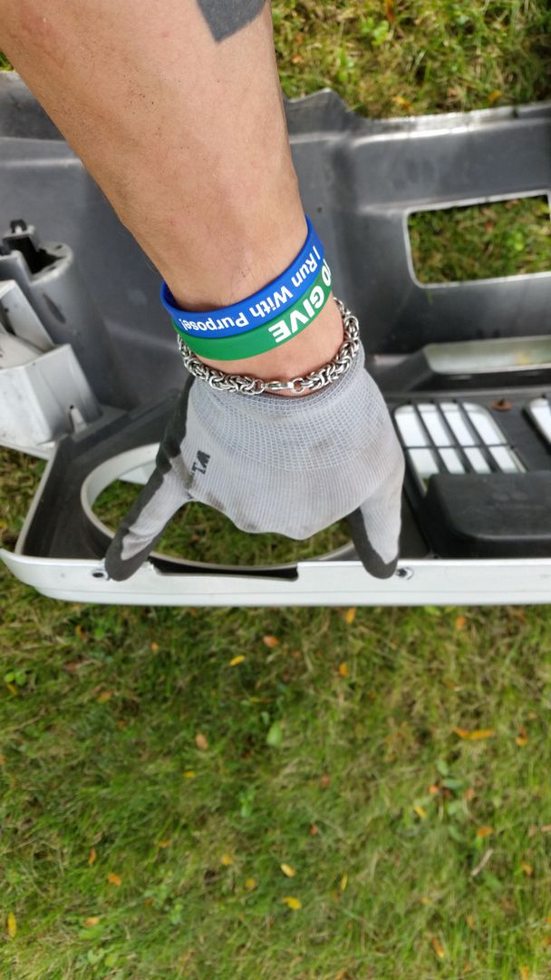

Here it goes:
Front bumper is off in this pic and the splash guard is lowered:
(please note that it is definitely necessary to remove the front bumper as there is little to no room to access the actual petcock without removal)

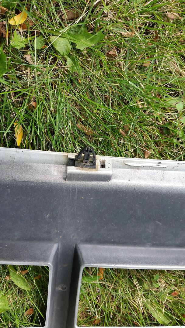

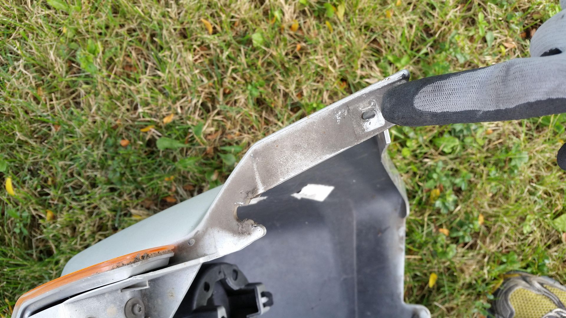

2 clips on the underside:

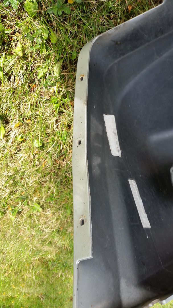

Several screws on top of the grill location:

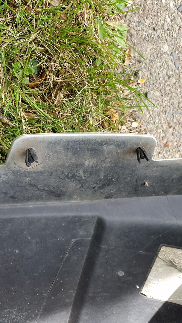

2 push pins on each (bottom) side:
3 7mm screws on each side of the splash guard:
1 more screw behind the splash guard holding the bumper on:

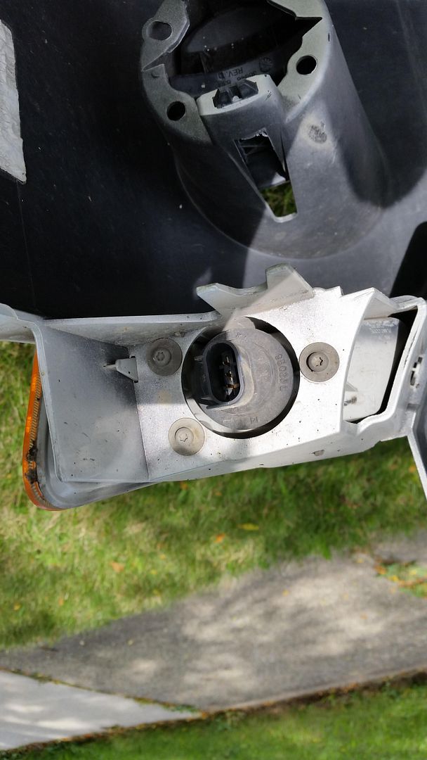

UNPLUG the lights/side markers:

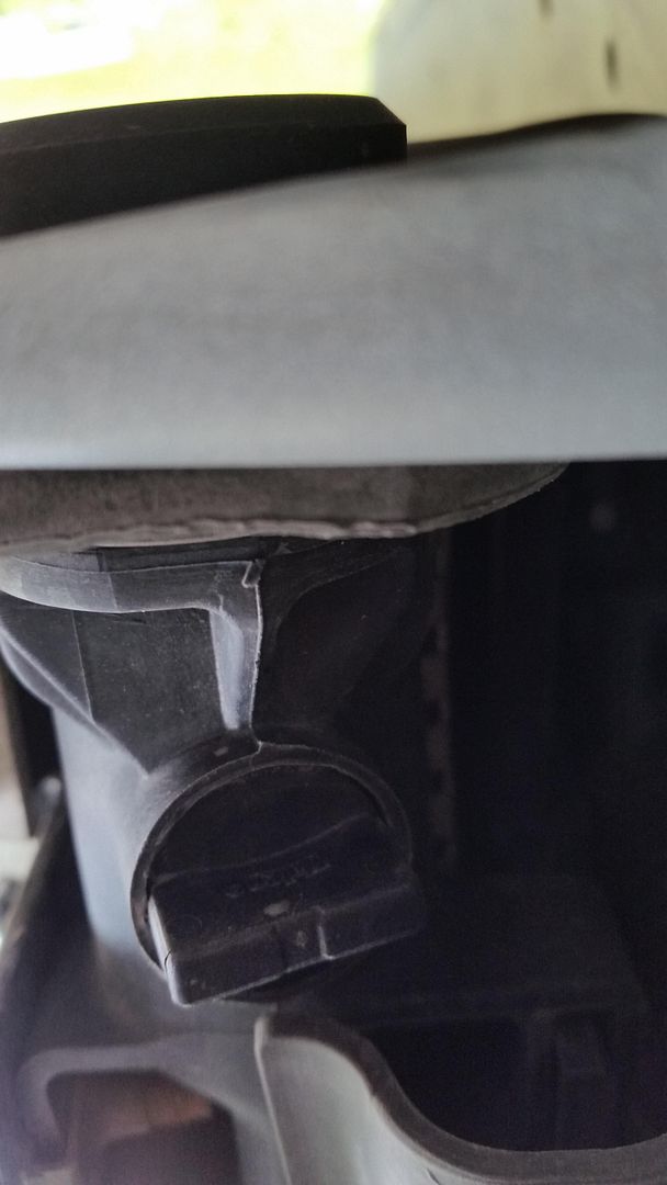

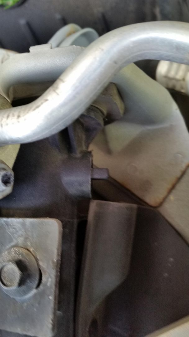

Petcock location:
Side view of the petcock:
(note that you will have to turn this petcock counter-clockwise a couple of times as well as almost pulling it out while turning. This ensures that the petcock opens all the way. Terribly tight in here as well!)
