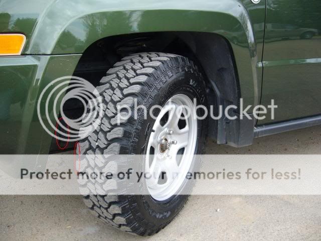

So after being torn on what tire to get, the final straw came when crappy tire had their buy 1 get 1 for 1/2 price deal.
I decided to go with the Goodyear Wrangler Territory in LT225/75/16
Here's the specs of my jeep:
Stock height FDII using the patriot 16" steel wheels.
As you can see in the pictures no problems clearance wise on the spring perch as well as that little piece of plastic in the wheel well.
They do rub at full lock although since they clear the above mentioned obstacles I don't know where it is rubbing, not a big deal at all and it doesn't bother me either.
In terms of ride and handling, they are loud, not like a humming loud but its more of a whoosh type sound, similar to a set of winter tires I had on a previous vehicle. The noise isn't that bad altough for a daily driver some people might find it a bit much. They are heavier than the stock setup although I havn't noticed any adverse effects. Speedo is off I presume but not a big deal either.
As for performance offroad, they have been on for about 2 hours, and as you can see my Pat is rather clean at the moment, later tonight or tomorrow i'll go hunting for some mud to see how they perform.
So in my opinion, 225/75/16 fit on an unlifted FDII and most likely FDI rather nicely.

#6 ·
I saw that ad too! Probably would have gone the same way, had I not gone to Portland for tires.
at 29.3", they probably need the plastic bump melted out of the way a little, but I think you'll be OK not needing to do anything with the metal under it.
Nice!

Alright so I must be blind as a bat but I couldn't find the treadwear rating or the traction rating ect that is usually on the sidewall of tires, I hope I can get around 50K out of them, which will take forever because they won't be on year round.
As for the plastic part in the fender I'm probably going to have to cut it away, no big deal.
I can only imagine that I'll be going out and getting really stuck this week to test the tires out:pepper:

That's a pretty aggressive tread pattern for an all-terrain tire. Looks almost like a mud-terrain tire to me. :) Do let us know how they perform.

That's the size I went with on my Compass, using the 16" steels from a Patriot with BFG M/T's. It rode SOOOOO much better AND was great in the snow. I had NO rubbing issue on the Compass but the Patriot is slightly different in the shape of the wheel openings so I can't speak for it. If you do have some, it should be minimal and can be easily 'fixed'.

I've been rather busy today but my Pat didn't stay clean for very long. I found a small area with a bit of mud, although nothing too crazy so I'm sure I didn't test out the true ability of the tires, but i'm very impressed.
They clean out the mud very well and don't seem to get too caked up, they actually throw it pretty good, from the small amount of time I had to play.
I did get some video's, they are still uploading, and they aren't anything special, but here's the first dirty pic of the Pat with its new shoes.

I can't see why they wouldn't work, the lift from the FDII (1/2" spring wise) isn't making any extra room in the wheel well as far as tires this size are concerned.
The only rubbing is a tiny bit before full lock, but other than that not too bad, one warning though is that they are a bit on the loud side.
